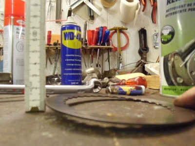

I´m not sure that the problem you describe comes from the missing dished plate, but I thinh it´s important to have one to avoid a digital clutch (all or nothing). As mentioned the neutral should be found while the bike is rolling.
This is a dished plate in good condition
