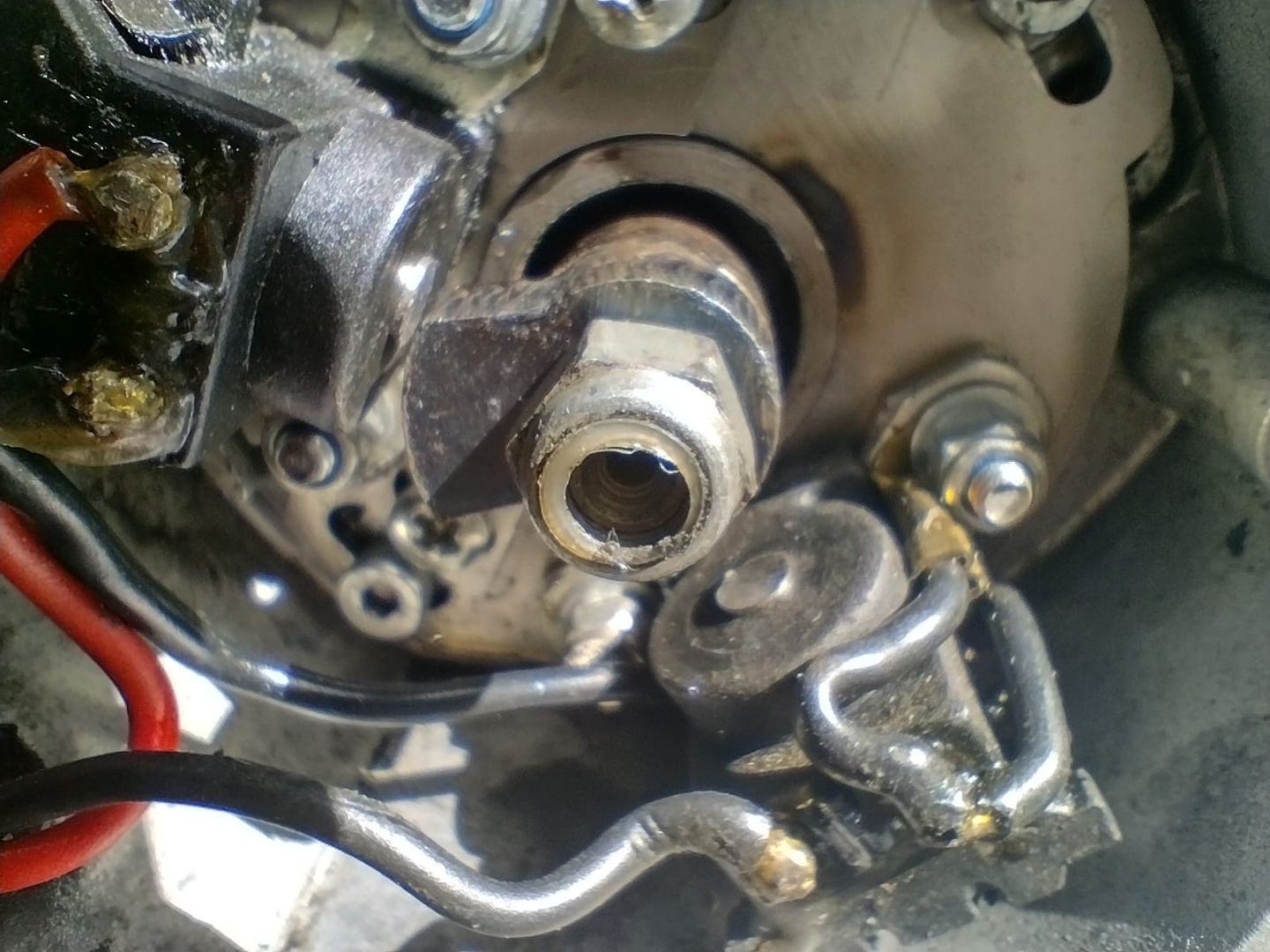

Hi folks, Bev bought a Strada 8 months ago and we haven't been able to get it running properly since. Initially it had a charging problem which Benji diagnosed as incorrect wiring. I connected it correctly so charging was restored. Rev counter wasn't working so I disconnected the loom to the RC. Ultrasonically cleaned the carbs and re built with new seals and gaskets. Checked ht leads, changed plugs, reset float heights, nothing has made a difference, it misfires badly under load. I did notice the ignition rotor has been making contact with one of the pickups. Does anyone recognise these? I reckon that's the next thing to try. I've got the carbs close with vacuum guages, and it's running same temps on both exhausts. It revs ok while stationary. Help!!

What an odd pickup. What is the ignition system?

That looks like the nlm "performance!" pick up to me - I think there is information on it in somewhere in the library - if you can't find it I am sure I have a copy of the instruction set up somewhere.

Yes, that's definitely the Nlm pick up. It shouldn't come into contact with the rotor but it dies need to be as close as you can get it. If it's been hammered it may be past its best now.

Looks the same as my NLM series 2 pick up. When I set mine, I used a small piece of paper to set the air gap so it was equal on both sides. Contact probably explains the misfire.

So, does anyone have one of the pickups I can at least borrow or buy to prove this is the problem please? We're looking at Mdina part number 46.05.65 model no M460565 to replace the whole assembly , if this is correct for a 1974 Strada.

Bugger, replaced NLM system with black morini pickups and matching transducers. Same problem.☹️ . Valve clearance check tomorrow, new ht leads, cam timing, anything else I can think of.
