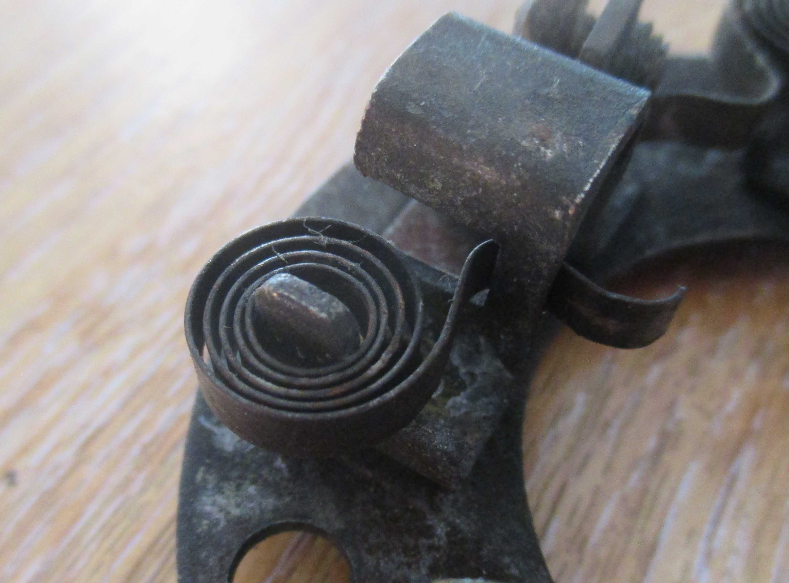

Hi every one
I started this thread and having got most of the bits I find on the final assembly that one the brush retaining springs is bent strangely.
The spring, when off the motor, is about 1 cm diameter with the tail about another ! cm.
Has any got a spare pair they can sell or give me?

Re: 1976 Starter motor field coils
hi i have an old 500 starter motor spring. I dont know if they are the same but suspect they might be. see pic. If suitable personal message me and we can arrange something
- motor brush.jpg (319.63 KiB) Viewed 3758 times
Hi
Many thanks for the quick response. That looks exactly what I need.
If I can work out the private message bit you we can set something up
Michael just let me know your address and I will post for free. Just forward on the goodwill to help another owner if you can.
cheers
Paul
