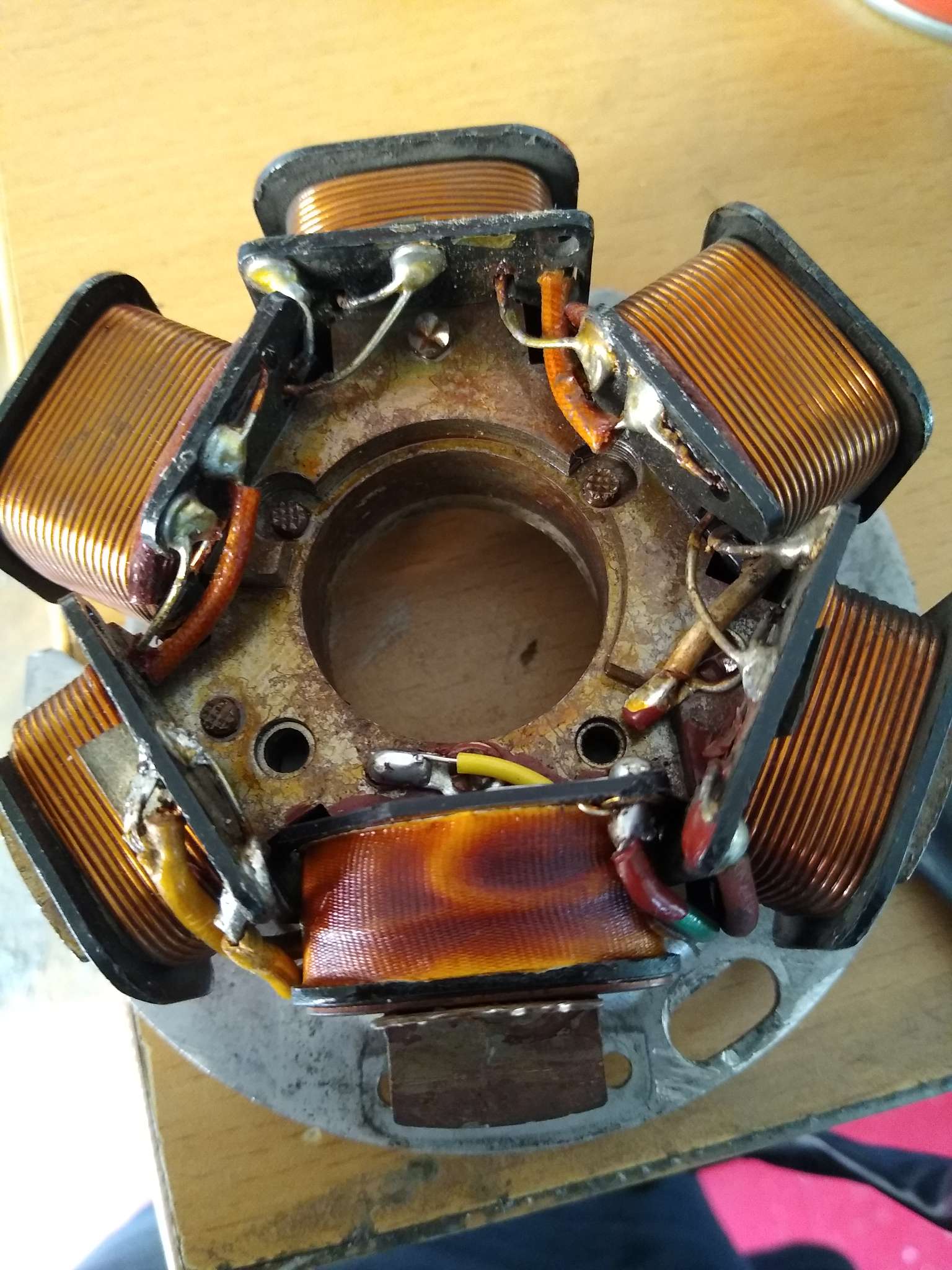

Ignition winding burnt out after 340 miles. I spoke to Sharon at West country windings and it's on its way back to them for a test there must be an underlying issue I can only think the permanent magnets are weak

I don't really know what to say, I am truly sad for you that West Country windings couldn't rewind the coil the same as the original
The generator winding is supposed to be a tall bobbin, not a short bobbin.
I reckon this has been wound with the wrong gauge of wire = far too small = too high resistance = too much loss = too much heat = burnt out
Where is the overvoltage rivetted keeper plate gone? I can see the rivet holes? but no metal plate
If there were a short of your green wire the ignition would be killed this is how the ignition kill switch works already.
This will need to be returned for rectification.
The bobbin is not to be wound like a scooter - which has typically 470 to 500 ohms but only has 1 CDI and usually lives below 6000 rpm
A full height bobbin should be wound with as many turns of 0.15mm class H wire* that can be fitted this will not in my experience and corroborated by others experience reach 300 ohms, more likely 260-270 ohms at room temperature The number of turns is around 3000

I advise the return of the overvoltage keeper as this helps to protect the transducers from overvoltage (spike) damage

The plate Mark refers to above is a right angled piece of metal that look like a bracket to us uneducated types. It works by magic to stop the voltage produced by that coil. Yours is missing and as you said earlier your new coil was 470 ohms! So it was always likely to cause trouble and burn out either itself or the CDI (transducers)

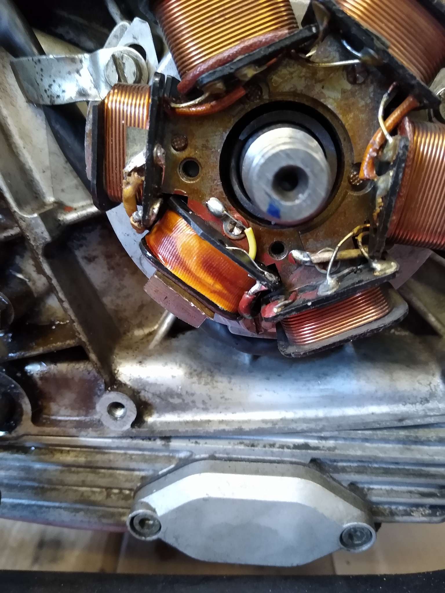

Well here we are again back to square one
Low tension ignition coil has burnt out again after less than 200 miles. I have emailed West country windings but there must be an underlying issue. Has anyone got any ideas for what to check next.
While the coil is okay the bike runs a treat starts first spin and revs smoothly all the way to the red line. I have checked all the wiring and all the earthing points every thing has very low resistance around 0.2 ohms. Can't see any kinked or squashed wires.

Re: Do I have an ignition problem
"When I tested resistance it was 129ohms it's now 470ohms well over the 300ohms specification."
I think Mark may be correct in diagnosing that the resistance is too high (assuming West Country Windings have rewound it in a similar way).
Perhaps 'resistive heat' is just cooking the winding?

That's what I guessed must be happening the winding must be acting like an electric toaster. I don't know the melting temperature of the wire insulation is but I am guessing it must be north of 100°C.72degrees wrote: ↑22 Sep 2023 14:26 "When I tested resistance it was 129ohms it's now 470ohms well over the 300ohms specification."
It's really frustrating I have missed a lot of good riding weather and now looking like I will miss the rest of September. Beginning to lose the love for this bike and I have started looking at Japanese twins.

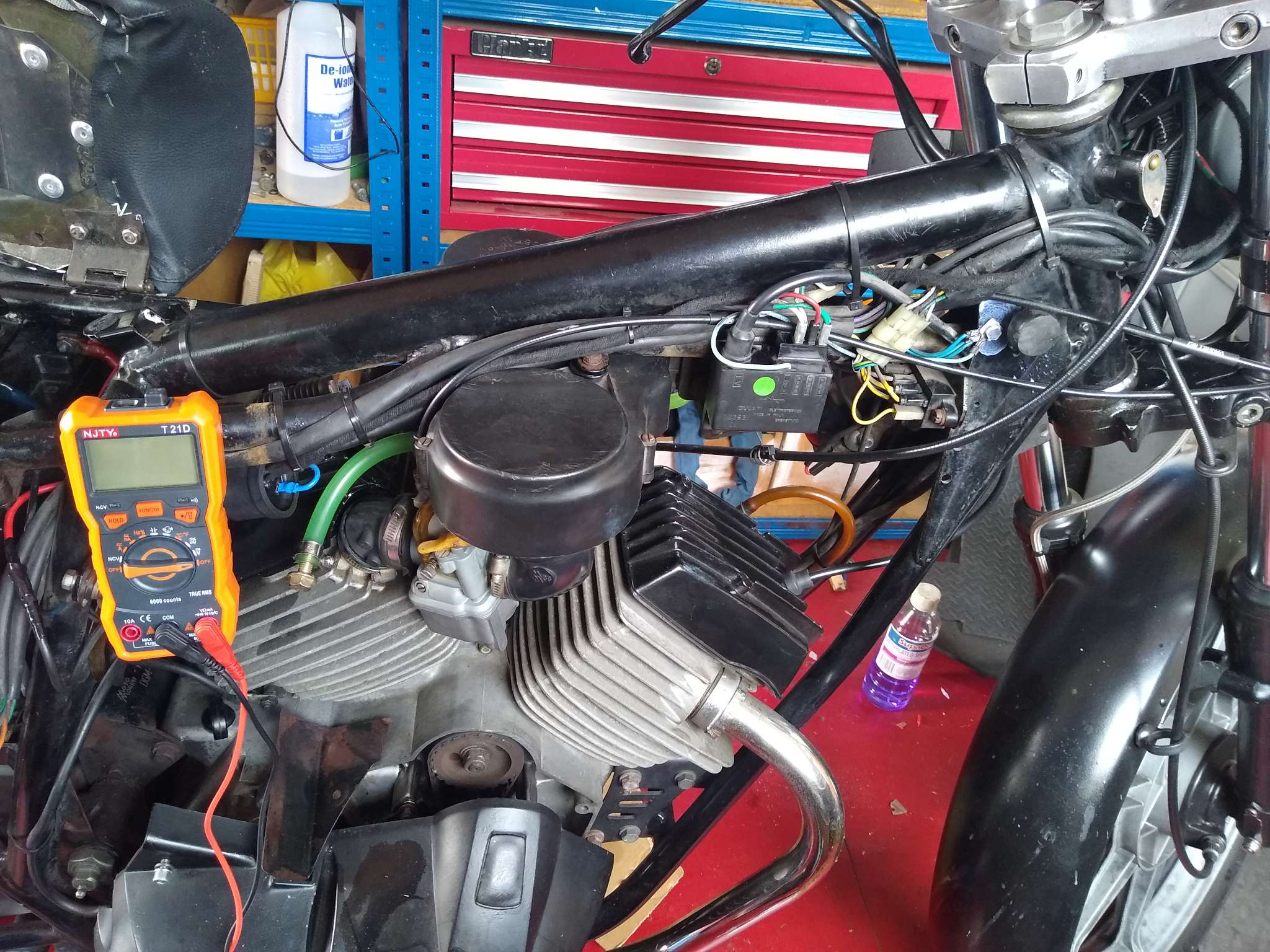

Is there any DC voltage on the coil with the ignition off or on?
Hi Fastmongrel
I would suspect that there is a rogue DC supply superimposed on the green wire when the ignition is switched on, try putting a multimeter in series with the green wire and checking for a DC current, ignition on but without the engine running. Ian C
Do I disconnect the green wire from the junction box and connect one meter probe to green and one probe to earth to test for a DC supply. Or do I put the meter between the green and the junction box green connection.
Sorry for sounding dumb I can rebuild a gearbox but electrical problems just make my head spin.
