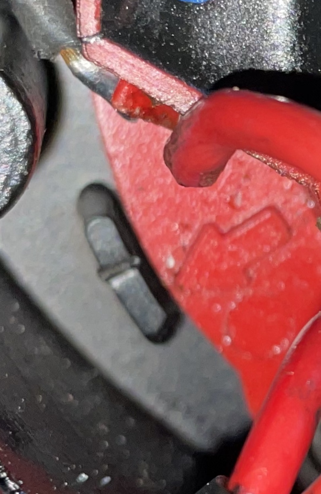

I’ve been running blue transducers with red pickup on my k1 for a while now and am happy with the way it runs. No need for the extra diode on the red pickup.
As discussed elsewhere in the forum and on Soren’s YouTube videos, you need to adjust the pickup timing to achieve the correct full andvance ignition timing. For me that meant rotating the pickup anti-clockwise as in the photo.
So long as the max advance is correct I don’t worry about where it is at idle- the Morini advances quite early, and so it’s hard to know what idle advance is actually expected. But so long as it starts easily (which mine does, very) then it’ll be ok.

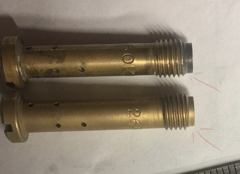

Hi hopefully the picture comes out. I have been having all these issues. Changed needles, atomisers and pilot jets (45).
The pilot jet made a small ldifference. With it getting worse I cleaned the carbs and the pull away judder and lack of power was worse. Cleaned the clutch and adjusted floats to 12.5mm maybe a bit better but when warmed up fully was just as bad. Took out the atomisers and compared them to the old ones. Visually you could see that the bit that sticks into the Venturi was slightly longer on the old one ( doesn’t show well on photo ) , also the hole at the top was different ( measured with a drill bit) and the centre bore felt slightly smaller on the old atomiser.( tested by rocking a drill bit in the bore )
Put the old ones back in and when warmed up fully, completely different bike. Smooth pull away no juddering. No loss of power on pull away, however did feel a little bit less powerful in the midrange. Good idle though!
This worked for me, not sure if you have changed or still have the original parts to swap back but it may help some else.

I guess the atomizer is not entering more in the venturi zone, but the rest of the atomizer will be a bit lower.
That reminds me of a sugestion many years ago:
A friend told me that the problem of the mid range, the famous leak of power about 5000, get´s better by putting a small 1-1,5 mm washer underneath the atomizer (means first the washer then srew in in the atomizer). I guess you have to make this washer your own, but obviously that can change a lot!

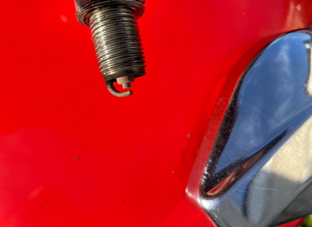

An update on atomiser. In the interest of science and I fancied a ride i took the bike out for about 15 miles. Bit of town bit of 60 mph roads. The photo is of the spark plug colour. It was sooty before ( I didn’t bother cleaning it ) so it has burnt it all off. It is significantly improved, no misfire/splutter/judder when pulling away. When on constant mid throttle then opening for overtake no hesitation. There is a noticeable dip in power when on 3/4 throttle, nothing drastic just noticeable, but as I said the needle is on the top clip position and the float is at 12.5 mm. Maybe worth a tweek…..later.
Gordon
