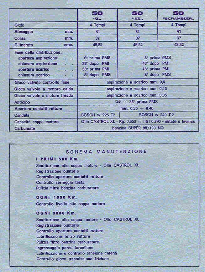

Corsarino spark Plugs. Any idea of correct specification please.
- Posts: 375
Re: Spark plugs
According to the manual, Bosch W225T2, and for the Zeta Zeta and Scrambler W240T2.Pennyfarthing1880 wrote: ↑06 May 2024 21:40 Corsarino spark Plugs. Any idea of correct specification please.
Equivalents can be found here:-
https://www.sparkplug-crossreference.com/
- libzz.jpg (56.66 KiB) Viewed 3579 times
