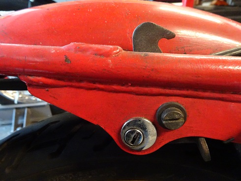

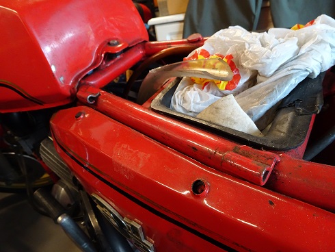

Your bike sounds very much like a K Strada. It should have a hinged seat. At the risk of sounding obvious (see photos), there should be a couple of hinges on the left side of the frame, and on the right a lock and hook, or possibly two holes where they used to be. I don't know for certain but I think a 500 seat would be a bit longer with the hinges in a different position.

- Hinges.jpg (116.04 KiB) Viewed 4536 times
- Lock.jpg (101.99 KiB) Viewed 4536 times

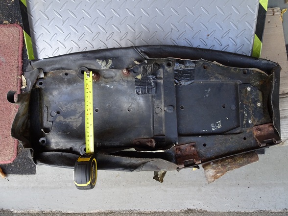

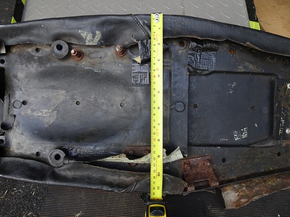

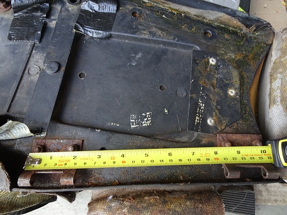

By way of comparison, my seat is:-
Overall length: 670mm.
Width at front end: 205mm.
Width at rear: 245mm.
Width at widest point: 290mm.
Length beween outer edges of hinges: 260mm.
Centre to centre of rubber buffers: 185mm.
If you need me to do any more measurements I can do.

- 290mm.jpg (148.97 KiB) Viewed 4520 times
- 260mm.jpg (171.71 KiB) Viewed 4520 times
- 185mm.jpg (151.07 KiB) Viewed 4520 times

So useful primarily because a previous owner has cut off the mounting tubes on the frame in an attempt to fit a seat to make it look like an earlier Strada, so I'll have to weld mounting tubes onto the frame, the photo gives me a great start as to where to mount them. No locking/release bracket or any mechanism to lock it into place either, I'll have to keep an eye open for that.

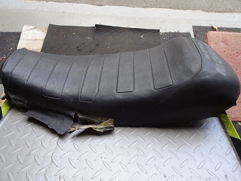

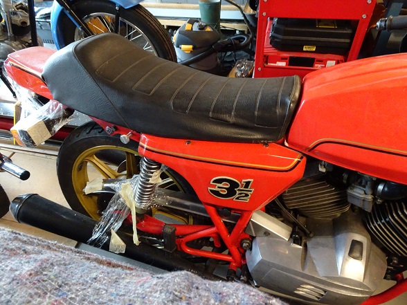

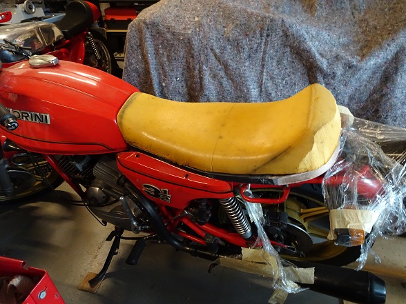

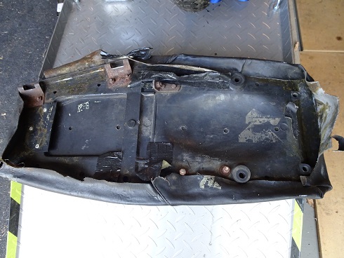

I have attached some photos of the K Sport seat which is surplus to requirements. It wouldn't take too much to refresh it but as you can see it is missing the plate for the lock to engage with and also the rubber buffers.

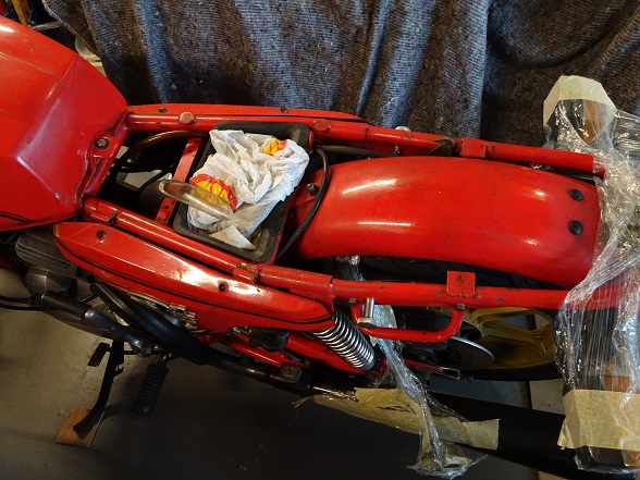

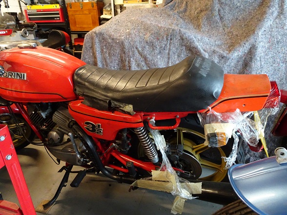

Interesting to hear that the previous owner of your bike cut off the mounting brackets in order to fit an early style Strada seat. I am part way through doing something similar although it is a bit of a tale...
My bike is a K1 Sport which as you know has a fibreglass unit running from the fuel tank to a large-ish tail piece which also has a handy storage compartment. The seat itself locks on top of that. I quite liked the look of it, but some time ago I had a sit on my friend Sally's K Strada and found that the seat was a good inch lower than the K1 and, having short legs, that appealed to me. Upon removing the K1 tail unit I was surprised to find that as well as the K1 mounts on the frame, there were also two seat hinges, two pairs of threaded brackets for side flashes, two holes in the frame for the seat lock, two holes in the mudguard and two small holes in the rear light bracket. In other words, all that is necessary to fit the K style seat and tail.
So, I picked up a couple of K seat bases, side flashes, and a tail piece from an autojumble somewhere and bought the lock mechanism and key from NLM. I merrily set to, cutting off the surplus K1 frame fittings. Like an idiot I also cut off the brackets for the side flashes so I couldn't fit all the K parts I had but it wasn't too bad really as I was aiming for the look of the early Strada seat anyway. As you can see I have reshaped the K seat base and it all works and locks as it should but I still need to sort out the foam and cover.
I'm pretty sure the K seat base is the same for both the Sport and Strada, just the shape of the foam and cover is different. It wouldn't be like Morini to make two items when one would do!
Still, here are some photos. If you need any more measurements just ask.
- Seat 01.jpg (111.48 KiB) Viewed 4393 times
- Seat 02.jpg (108.56 KiB) Viewed 4393 times
- Seat 03.jpg (111.06 KiB) Viewed 4393 times

- Posts: 375
Re: Strada ID and seat
- Work in progress 01.jpg (159.14 KiB) Viewed 4392 times
- Work in progress 02.jpg (181.68 KiB) Viewed 4392 times
- Work in progress 03.jpg (162.92 KiB) Viewed 4392 times
- Posts: 375
- K Seat and tail 01.jpg (181.35 KiB) Viewed 4391 times
- K Seat and tail 02.jpg (183.02 KiB) Viewed 4391 times
- K Seat and tail 03.jpg (171.68 KiB) Viewed 4391 times
