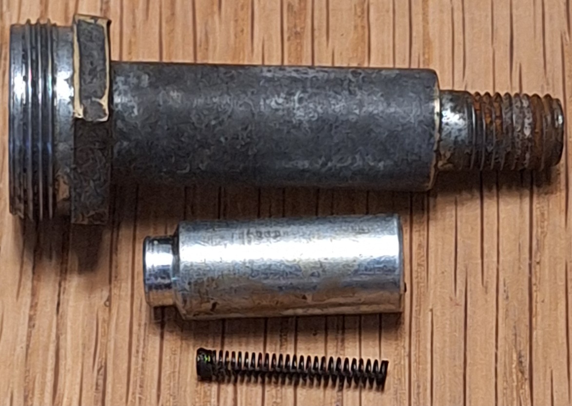

Has anybody got any tips for removing the plunger in the electric fuel tap . it appears to be seized,I have soaked it over a couple of days with rust flash / Wd40, it’s not sticking out enough to get pliers on it.
Is it just a plain steel plunger ? if so considering drill & easy out then replace it

Hi Barney,
As far as I know it's just a plain mild steel pin, shaped at one end to operate the diaphragm, and a hole at the other end to house a tiny spring.
You might want to try heating the outer and banging it down onto a block of wood to see if that will move it.
If you do have to drill it, I'm sure I have an old tap in the garage you can have to get the plunger from.
Regards, George

Thanks for the reply George and your offer, The drill with easy out sorted it this morning, turns out the hole was slightly distorted possibly didn’t help me tapping a tight spanner on the brass nut to undo it due to a slightly rounded nut.
I will hopefully find a reamer to clean it up and clean the pin up.
Don’t know if you or anybody could tell me what thread the brass nut and Aluminium block are ? these need a clean up first then hopefully reassemble and back on the bike

Can anybody tell me what the reading of the coil for the petrol tap should be please ? the plunger moves slightly with a fully charged battery but not enough to hold in, if I push it in it will hold, mine reads 36 ohms
