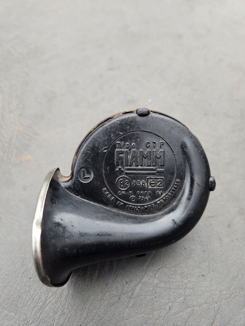

Which one do I need, anyone knows?
Cheers Paul
Sorry 1975 350 sport.

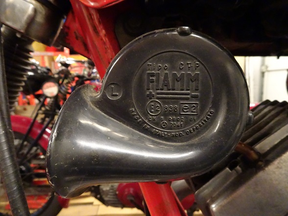

I'm 99% sure that it should be the same as the one in the first picture below. Obviously you'll need to check it's a left hand one and 12 volts.
The second picture is of the horn on my 1983 Sport K1. Mine doesn't have the chrome grill on the front and I'm not sure if it left the factory like that. Still, the writing on the side is the same, and it reads...
Tipo CTP
E2 838 e2
CH 5 0602 01
A 7341
MADE IN ITALY . MOD . DEPOSITATO
Do you have a parts book? There is a specific mounting bracket, part number 15.06.15

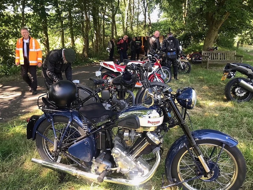

Jen, what’s the interesting bike in the background ?

It's not my bike, it belongs to my friend Geoff. It's a 1946 Panther Model 70 350cc with a four speed foot change gearbox. It is quite a rare bike. Geoff is a serial collector of Panthers of all sizes. Last April he bought a 250cc Red Panther and the seller insisted that he also took a second Red Panther project bike as part of the deal, so Geoff ended up with eleven Panthers in his garage and no room to move. He kindly asked me if I would take the Model 70 and keep it up and running for him while he sorted his workspace out? I didn't need asking twice. I've done about 1200 miles on it since then on VMCC runs and some local back lane bimbling.
It's no Morini but it is still good fun to ride on the right roads. It vibrates a fair bit at higher revs and although it'll go over 50mph it is most comfortable around 35-40mph. There is a knack to starting it, which took me several weeks to get the hang of. It handles o.k. but I check the tyre pressures before each excursion as they are quite critical. I've found that 20psi front and 22psi rear works best. The front brake is utterly feeble but the rear one is fine. It's best to keep a good margin behind other vehicles and definitely worth standing on the footpegs if you're heading for a pothole. Another thing I have found is that modern car drivers haven't got a clue about the limitations of classic motorcycles and pay scant attention to hand signals. The last time I rode the bike was on a Boxing Day VMCC run so I'm looking forward to the warmer weather... Geoff won't be asking for his bike back anytime soon....

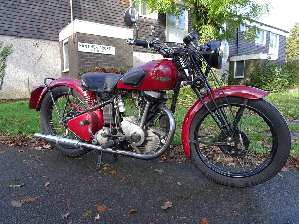

The picture below was taken on a sightseeing tour of Shard End, Birmingham, last October.

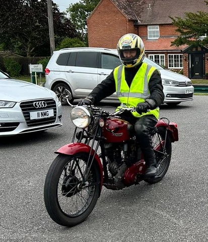

Pictured below is Geoff (in the hi-viz) and his tele-rigid 600cc Panther M100 which I think is from 1951. He kindly let me ride it a couple of years ago when we did a club run from Birmingham to a Motor Museum at Calne in Wiltshire. The M100 was a delight to ride although there were a couple of stumbling blocks for me. A) I didn't have the strength to heave it onto the rear stand, and B) I didn't have enough 'oomph' to kickstart it, even with the half compression lever in position. Once rolling though, it was great, and once on the quiet lanes it would bop along at low revs and it felt as though I could go round the world at 40mph.
