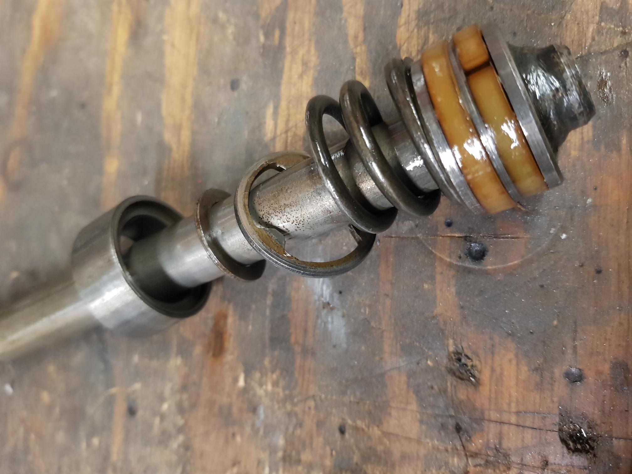

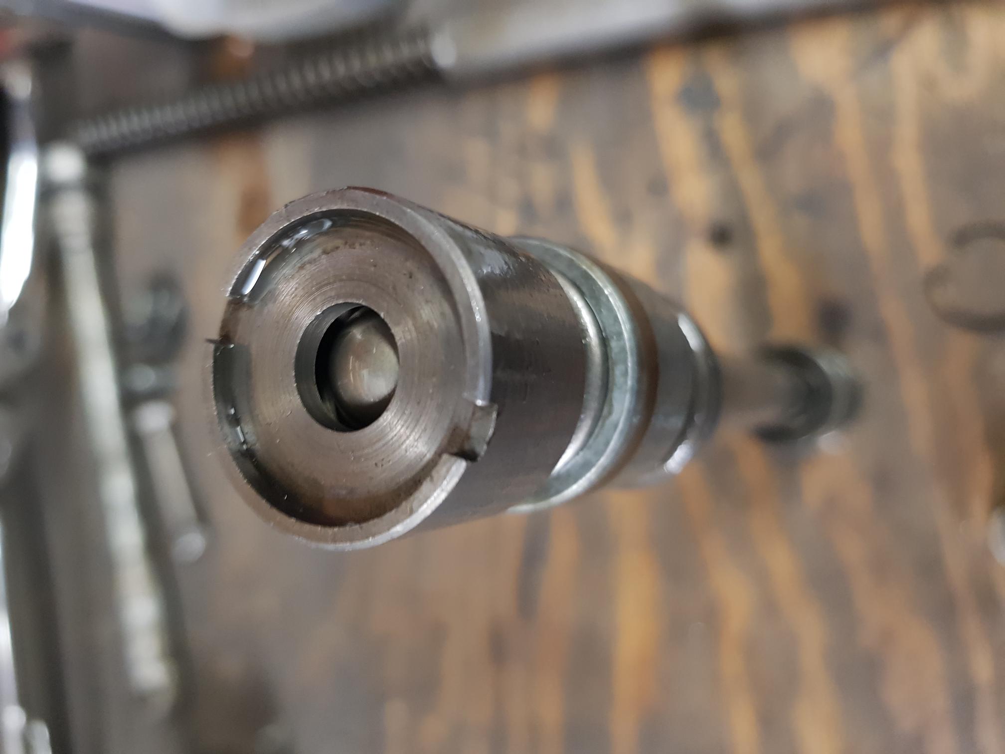

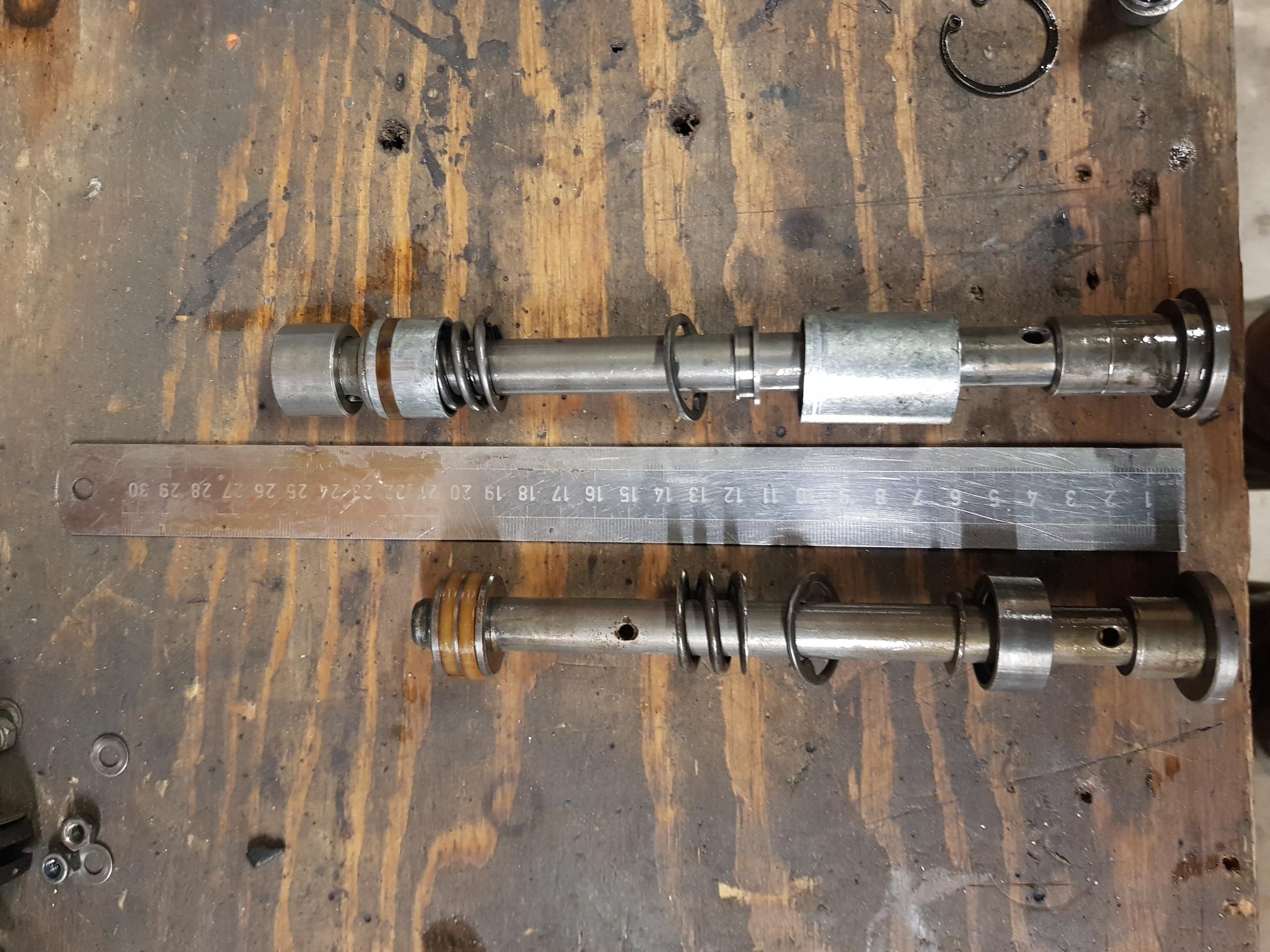

As part of my fettling/restoration of my 3½ I thought I'd renew the fork oil. Having removed the fork caps I noticed things didn't match on both sides.
The offside fork leg contained what looked like a pretty standard spring with the long shroud over the top. No shroud on the nearside as the spring is a larger diameter. Closer inspection shows the nearside spring to be progressive wound and 505mm long. The offside spring is constant rate and is 457mm long. The top spacers are both the same length and came to just below the top of the fork leg. The different spring lengths led me to conclude that all is not right lower down in the fork leg. Sure enough, different damper rods. I seem to have a standard damper rod on the nearside combined with the progressive (Hagon?) spring, meanwhile on the offside I have a standard spring (not sure what the correct length should be) with a mystery damper rod. Can anyone identify the damper on the left please? Edit to add: oops, I meant the one on the right. Now identified. Thanks Norbert 👍
Currently faced with replacing one or both of the springs and one of the damper rods.
On the standard rod there is a spacer that has a counterbore. Does anyone know which way up this should be? I'm not sure if it's been assembled correctly.
Thanks and regards
Howard

:oops: The left one is the normal Marzocchi rod. The richtig one Paioli as mounted in the drumbrake forks. I supose that the stancions have different threads for the top screws? The bottom parts of the legs are both for drum brakes or discs?

The stanchion with the Paioli damper has a finer thread and the stanchion is 10mm longer. The circlip at the bottom is further up the tube than on the Marzocchi one so that kind of compensates. However, the counterbore on the Paioli stanchion goes a lot further up inside. I now understand the longer sleeve at the bottom of the Paioli damper.
Anyway, I've bought a second hand Marzocchi spring, shroud, and damper rod from Mdina so that should make things equal again, or more equal than they were. I'll turn a new sleeve to enable the Marzocchi damper to fit the Paioli stanchion.
My fork lower legs are both Marzocchi disc brake items.
I did wonder about splashing out on Hagon progressives but that's always something I can do later on if I don't get on with the standard set up. Might be fine as I am very light - akin to the 'Italian Youth' that someone somewhere else said the Morini was originally set up for :lol:
