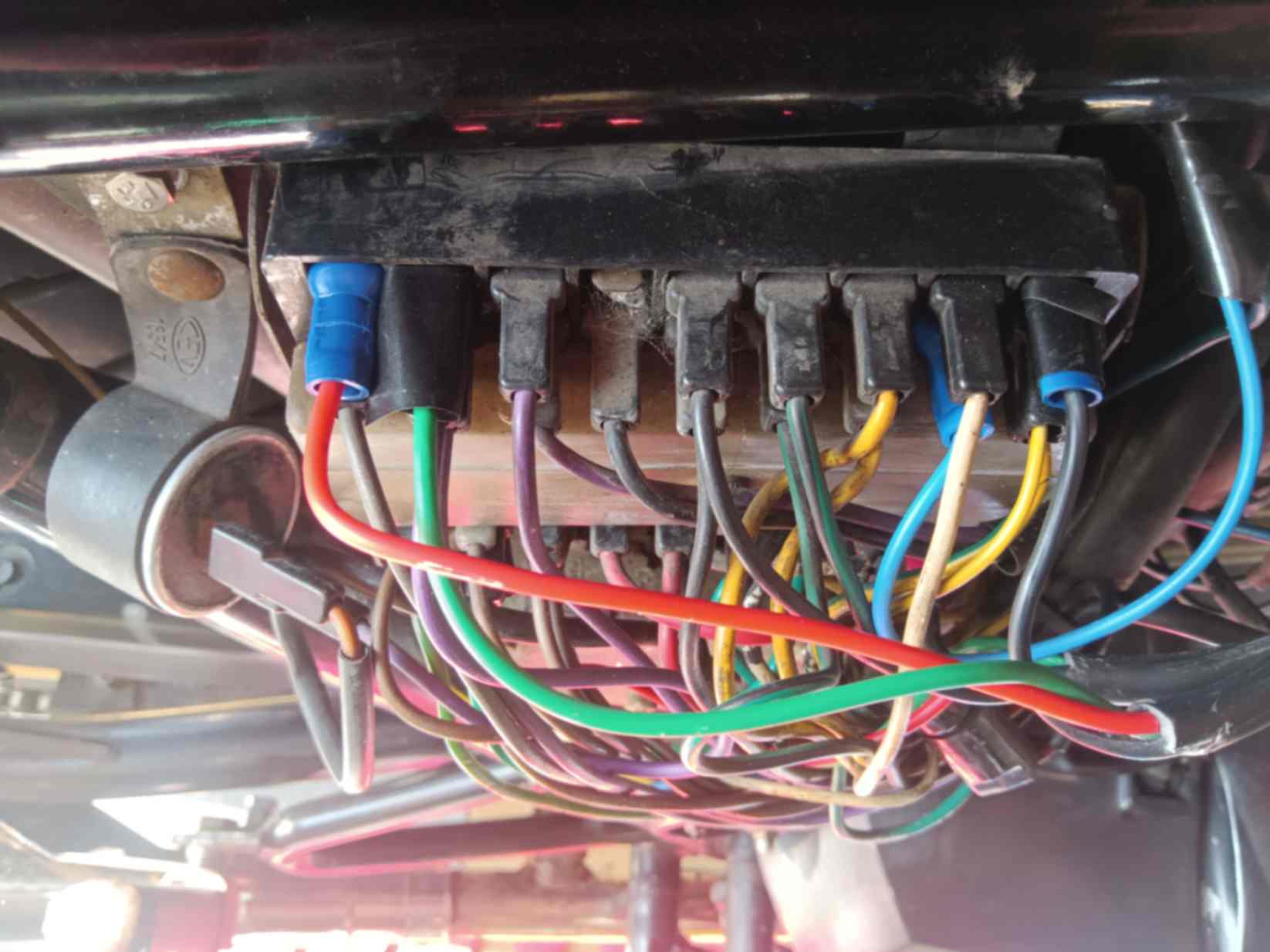

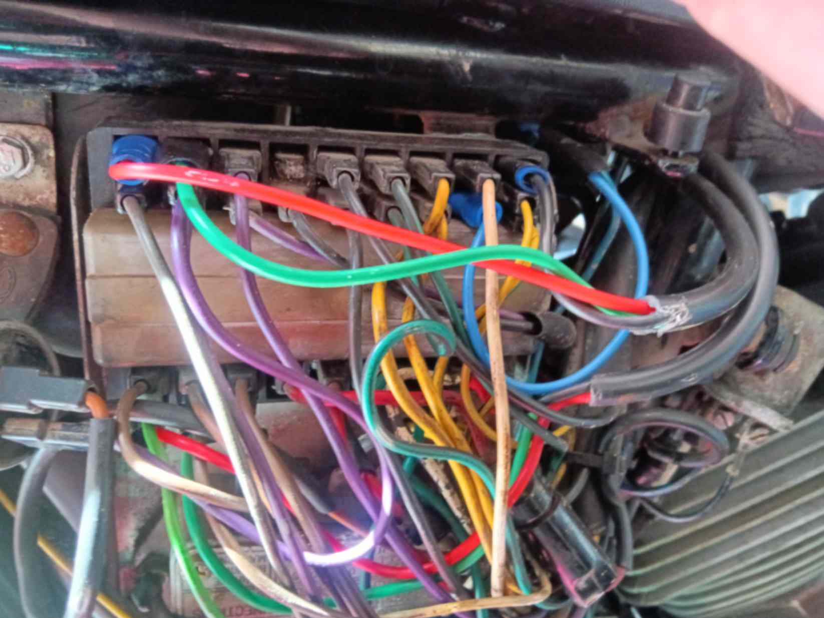

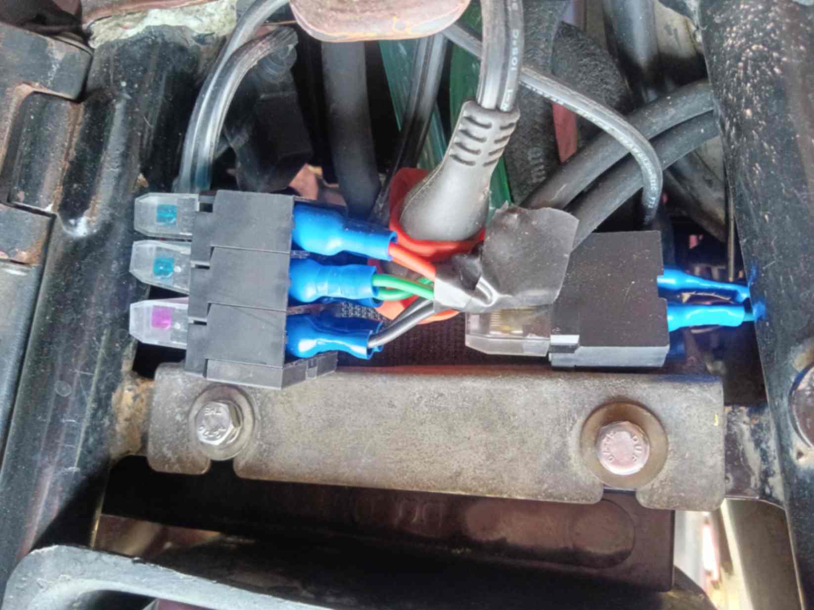

I made my own fuse wiring. All you need to do is plug each side of a new fuse holder to each side of the fuse box where each fuse is located. You need to piggy back one or two, but you can still use the original fuses if required. Completely reversible, too. Check the existing fuse rating and choose appropriate guage wire.
I mounted the fuse holders on the battery top holder using velcro.

I did not use in line fuses. I'll post some photos. I made up wires and crimped some spade terminals.

Hi Joe,
Photos attached. Sorry for the delay, I forgot! You can see the two cables and three wires in each going top and bottom. Not the neatest of jobs I admit but it does the job and I carry the old continental fuses with me. Ignore the fourth fuse, it is for my non standard ignition.
