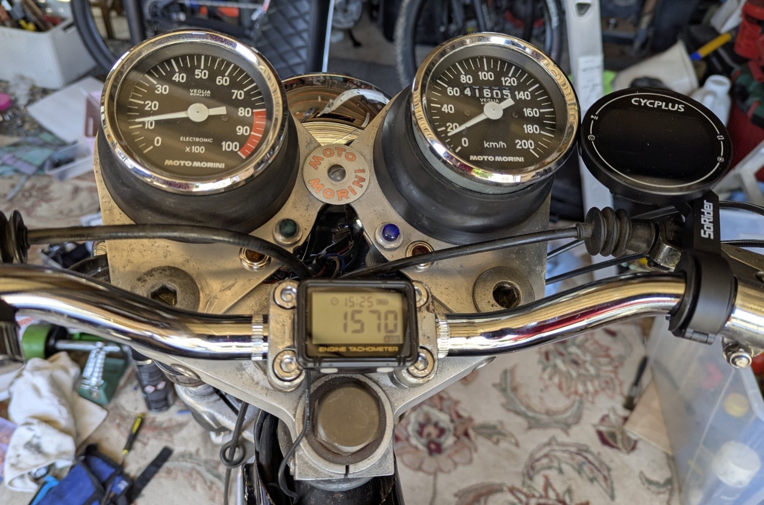

Another vote for Cycplus, but I use the M2. Also bought a nice bracket for it. Got to love AliExpress.
reduced 3.jpg (498.47 KiB) Viewed 2859 times
