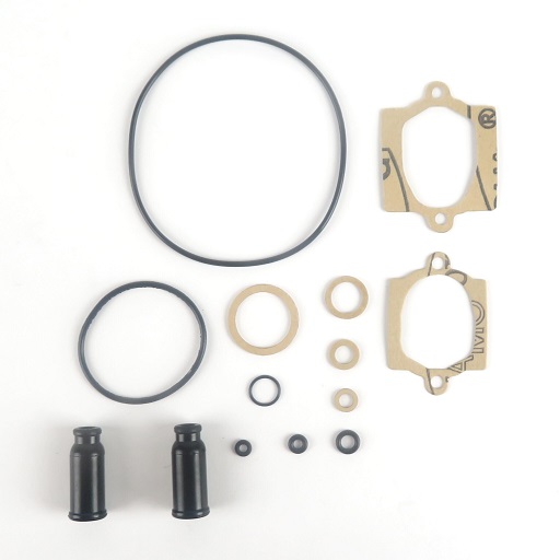

You shouldn't need any gaskets as a matter of course although there are a number of 'o' rings which can become hard or crumbly over time. The seal kit shown in the video is the 52510 set, available from Eurocarb.
52510 VHB Gasket Set.jpg (34.99 KiB) Viewed 1533 times
