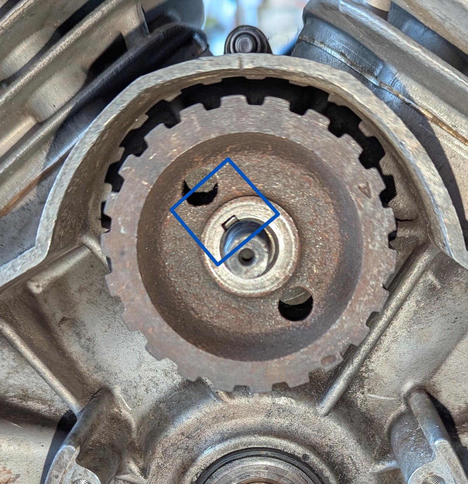

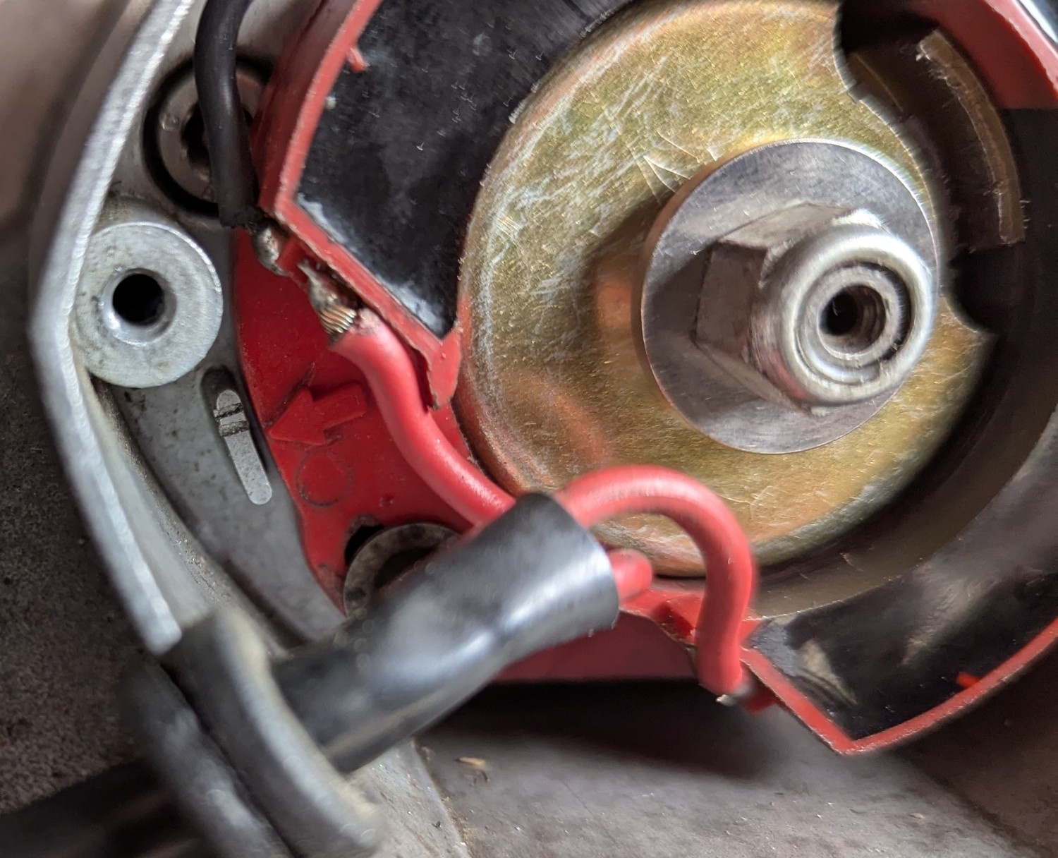

I have now removed the nut holding on the camshaft. The woodruff key appears to be there, so I will reassemble it. The sprocket is tight on the shaft, and if it is keyed in place, I am happy that it is not moving, and is in the right place, as there is only one slot.
PXL_20250822_145350276 (1).jpg (498.94 KiB) Viewed 1944 times
Posts: 2729
Re: Ignition Timing
If this is in response to my above post, then the slot is irrelevant. The dot on the camshaft pulley needs to be at the bottom (180 degrees from the notch on the crankcase where the ignition timing is set) when the crank is at tdc on the compression stroke of No. 1 cylinder i.e. the Woodruff key on the crankshaft for the rotor is pointing to the dot on the crankcase. I can see the dot on the camshaft, which appears to be about 30 degrees out) and the dot on the crankcase but not the position of the Woodruff key on the crankshaft.

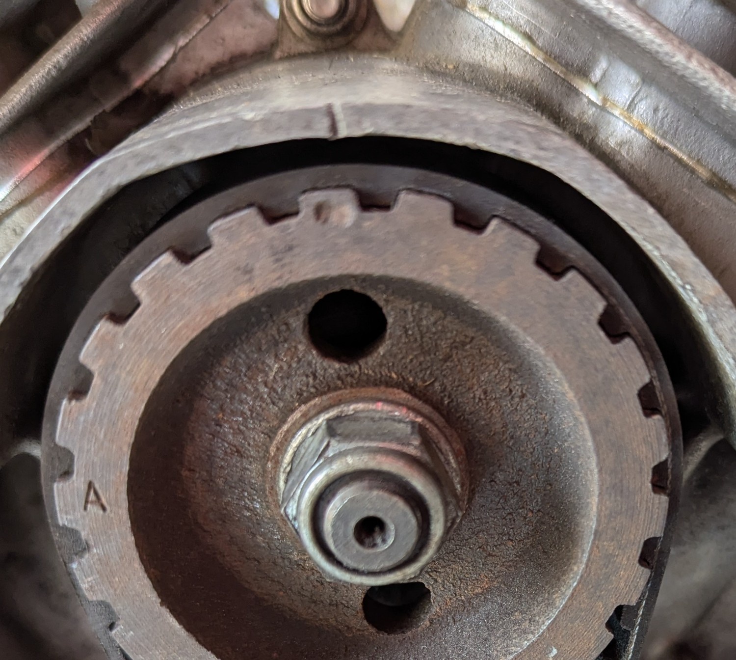

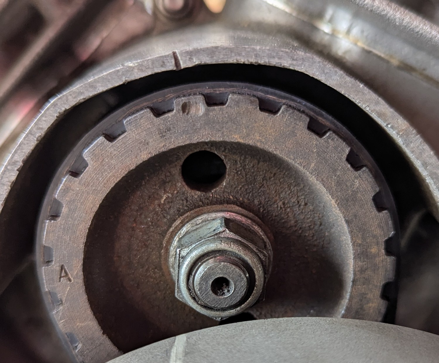

As I was checking the marks using the old belt which I cut to remove it, I noticed another mark that was made on the pulley. This mark enables the top sprocket mark to line up much more accurately with the mark on the engine casing. I assume that when it was last off, it was lined up with this mark. Hopefully this will enable me to get the timing marks lined up. 8)

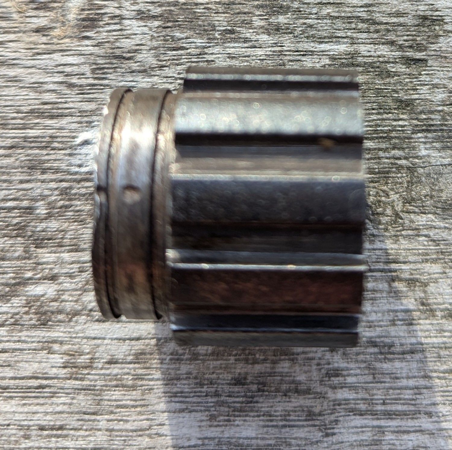

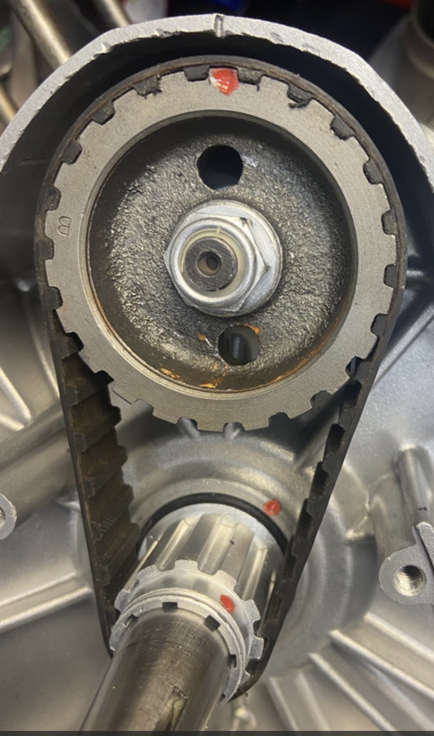

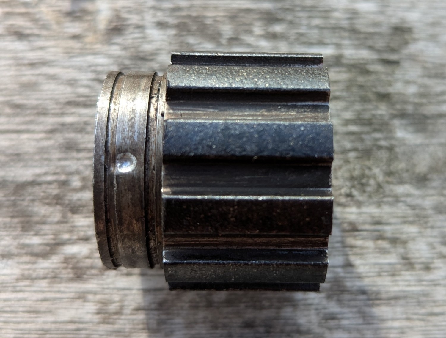

Posts: 1446
Re: Ignition Timing

That looks far too clean!

I started this thread because no matter how much I adjusted the ignition timing, I could not get the ignition timing marks to line up. I have discovered the reason for this was that the camshaft sprocket was put on using a different mark. Having set it to the other mark, the timing marks can now be adjusted into alignment.
Thank you for all your comments and advice on this, it has given me a greater understanding about my bike.
Old position:
New Position:
Ignition timing mark now within range:
While the diffence does not look huge, it was enought o enable me to set the ignition timing.
Posts: 923
Re: Ignition Timing
Now it looks like it should be!
Posts: 1446
Re: Ignition Timing
Glad it is sorted- that photo was not of mine , just seemed clear. Mine shows the usual mix of age and “deposits”.
