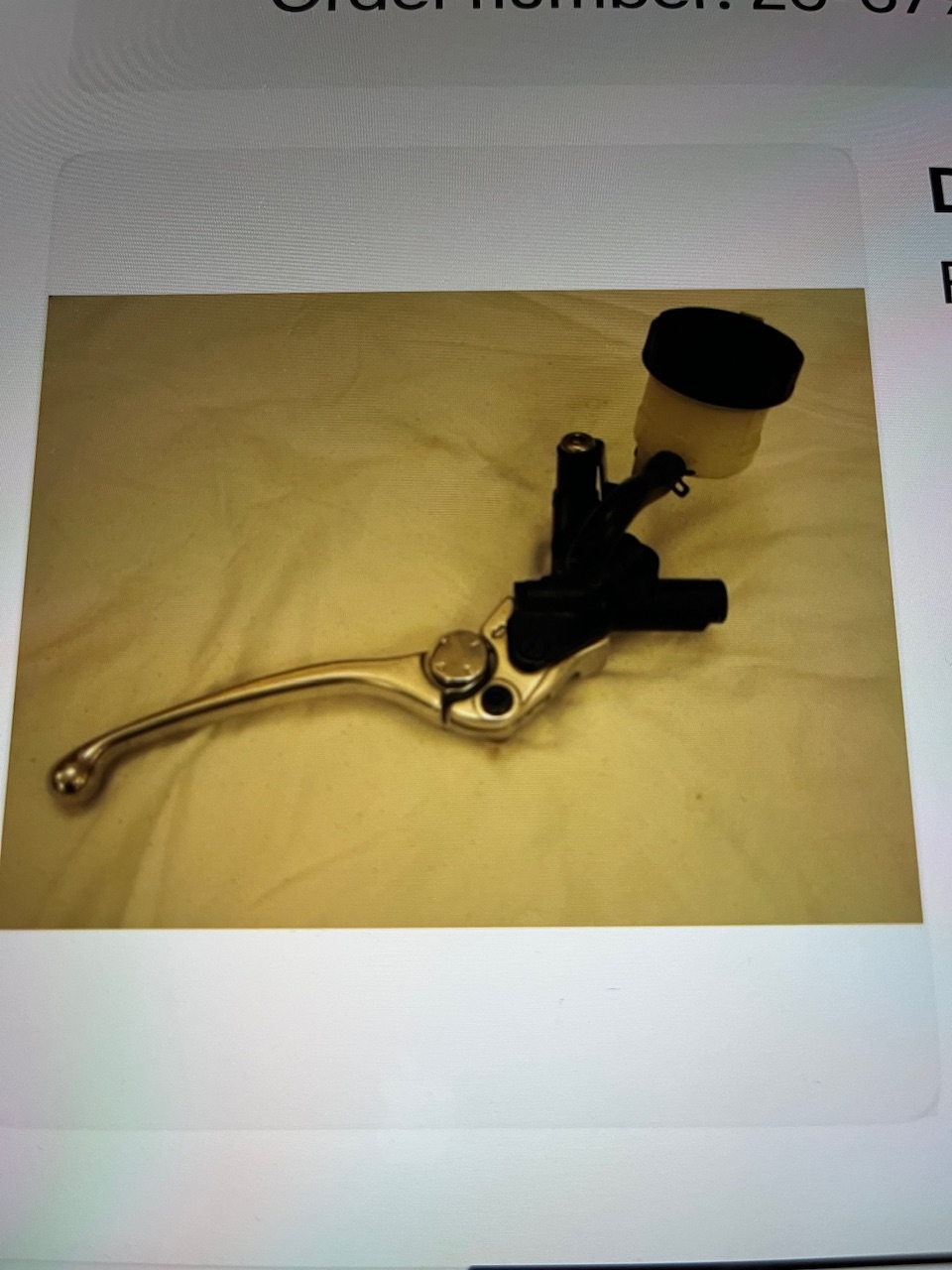

Paz2112 ref front brake master cylinder alternatives. I use a Triumph Sprint ST 955i front brake master cylinder ( other Hinckley models also fit ) which I got for 22 quid off eBay. Transforms the front brake action. Also use one on my Laverda triple.

Hello there was just reading through this thread and read your recommendation for a ST 955i cylinder - so all you have done is swopped out the stock master cyl for the ST 955i one, everything else is stock ?
Only asking because mine has double discs, and despite the brakes being very good, the action leaves a lot to be desired, if fitting a ST 955i cylinder improves things then it sounds like a worthwhile mod.

Hi Andy it’s a straight swap. You may have to have the Triumph banjo bolt as off the top of my head I can’t remember if it’s the same thread size as the Morini. It makes a massive difference in feel. I have the banjo bolts if needed. They also have an adjustable dog lever for the span which helps too.
Steve.

I was lucky and got this for £22 a few years ago.

Thanks for that, might give one a shot on mine.
If it gives the brake a bit more "feel" / makes it more progressive that will do me. As it is the brake is a bit binary !!
