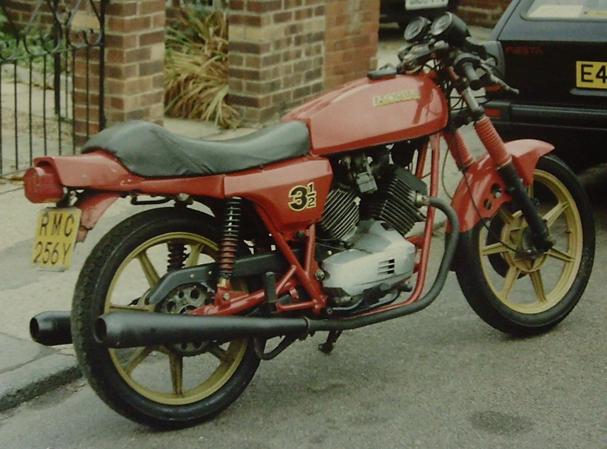

Just to amuse this photo is of the 350 sport I got in 1983, just before I sold it to a friend in 91. A man in his twenties (me), mostly only transport and no money to look after it properly (serviced well, but cycle parts suffered).
1983 to 1991 Moto Morini 350.jpg (488.2 KiB) Viewed 1151 times
