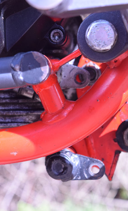

Mine is A US import (kinked frame but not a K, drum rear brake) and has the chassis mods and parts for a left foot gear change. I've no idea if this is a factory version of a home brew one.
The gear lever runs through a short tube in the corner of the chassis tube

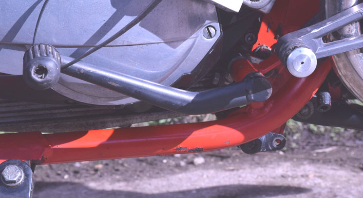

then via a short drop link
to a cross bar running through a tube under the back of the engine

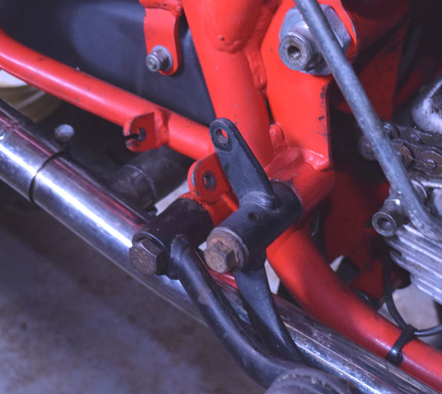

At the right hand end a little ear pokes up and has another link to the gear selector shaft

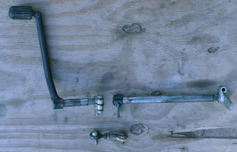

the various linkages

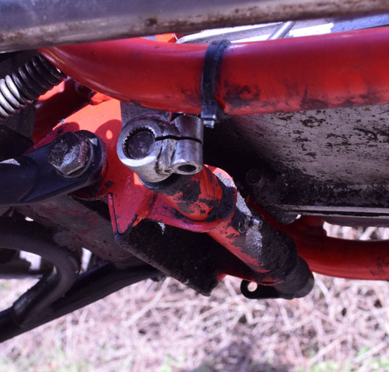

The brake lever has a simple mount for the brake cable and switch
however the routing for the cable must be a nightmare as it has to loop up and over the wheel, which can't be good for effectiveness
NB these were taken when first acquired the bike...it's cleaner now!
