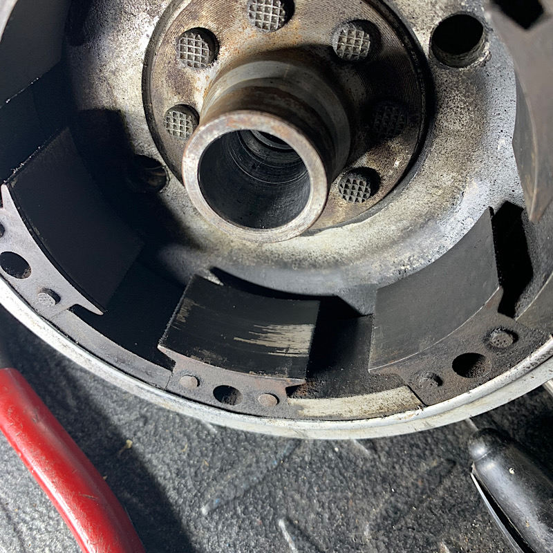

After arranging a date with Tom to pick up his rotor, I decided in the meantime to have another look at my rotor.
I sprayed the inside of the magnets with a thin coat of black spray paint, then reassembled and ran the engine up.
Obviously no change,however when I extracted it again I could see exactly where one of the magnets was rubbing on the stator.

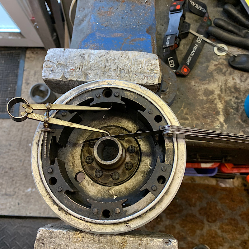

I didn't want to take too much metal off so I measured with internal calipers between the magnet that rubbed and the central boss and also the magnet opposite.
There was a 0.10-0.15 mm discrepancy, possibly due to the rotor being badly handled or the use of a 3 legged puller.
There are definite marks on the back of the rotor to suggest this. My trusty Dremel then decided to give up the ghost, so I ordered a cheap replacement from Screwfix.

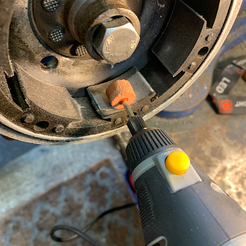

With the new fake Dremel, I set to with a rotary stone. I carefully removed metal until the internal calipers felt the same in the gap either side of the rotor .
I then cleaned all the filings off the magnets with compressed air and an old toothbrush.
After fitting the rotor one more time,I now , finally,have a very quiet Morini!
