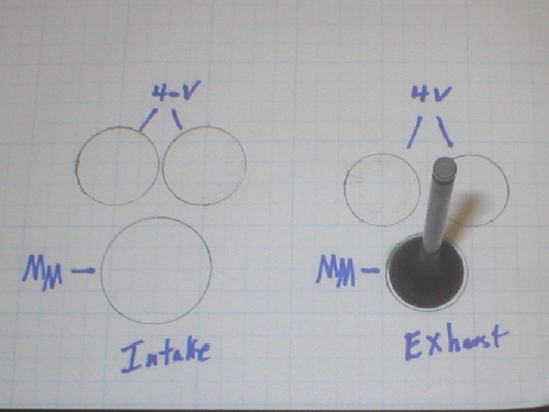

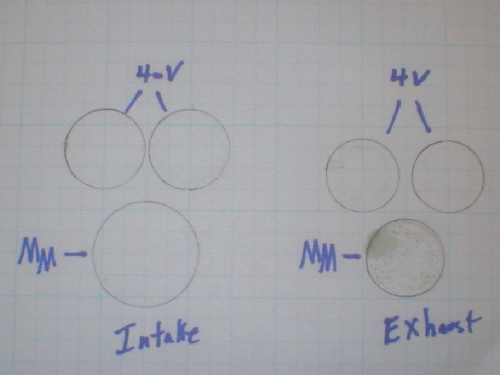

As promised, I've crunched the numbers for 4-valve cylinder heads on a 350's bore and the results are:
A 22% percent area increase on the Intake side and a whopping 81% area increase on the exhaust side.
This takes the valve stem areas into account, and I used four valves that will actually work on a 62mm bore.
Now, this is what it all means, more or less, is a potential power improvement of 25% to 30% over the OEM 2-valve setup IF all the other bits involved (cam, ports, exhaust & intake lengths, etc) work well with the 4-valve breathing potential. No small thing.
22% on the intake is 22% more potential power, but 81% on the exhaust side is usually only 8% or so overall flow improvement (rule of thumb) as the drive pressure is 10 times or more higher on the exhaust side of things...
One would get just as much addition power from big bore cylinders/pistons fitted to the engine with a lot better "bop-about" manners to live with... Cruising along at 35 mph in 6th and adding lots of throttle and smoothly pulling up to speed would be a thing of the past with a full-race 4-valve setup.
As I'm locked-in to using the stock bore and stroke I don't have that option available.

- 4-valve exhaust valve sitting on a Morini exhaust valve outline
- P1010107ss.jpg (80.44 KiB) Viewed 10610 times
- Morini and 4-Valve valves traced on graph paper
- P1010101ss.jpg (77.43 KiB) Viewed 10610 times

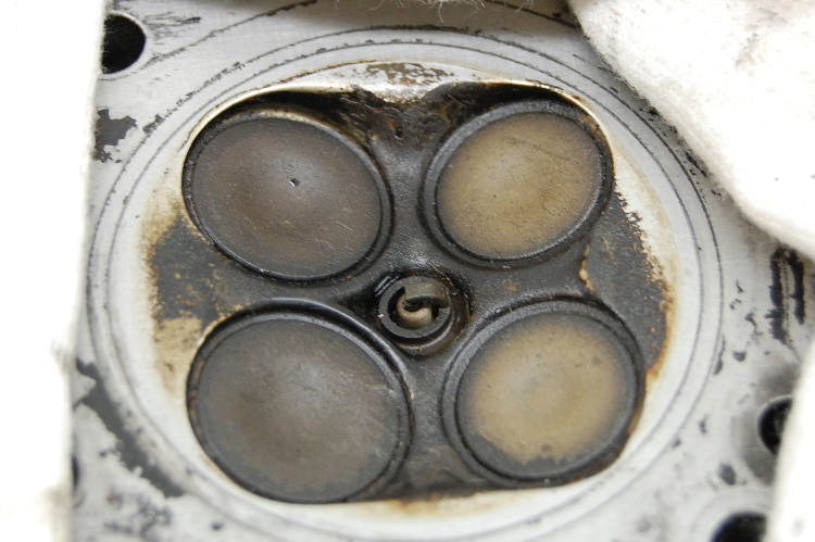

- Modern 4-valve combustion chamber with central 12mm sparkplug
- DSC_0459ss.jpg (179.29 KiB) Viewed 10610 times

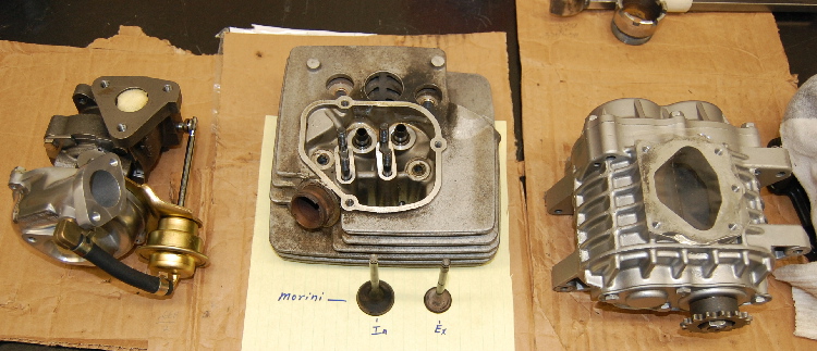

- Turbo or Roots Blower ? which to use ?
- DSC_0481ss.jpg (168.03 KiB) Viewed 10562 times

yes I have the custom 350 bits, the 500 Turbo is in the Morini museum untouched
What I am planning is changing the 350 cilinders for 500's (so bore 69mm and stroke 57mm making it an 426cc) and in the process of lowering the cilinders from 64mm stroke to 57mm reducing the compression to 9:1. And I am leaning to using 500 heads with a smaller 350 intake valve (but keeping the larger 500 exhaust valve). I could keep the original intake valve too but as 500 heads are prone to rupture between the valves (there is 2mm of flesh left between the seats) I could solve this by changing the inlet to a smaller diameter so the changes of rupture are reduced much
Brian assured me the turbo system worked OK back then but ran rough because there was no plenium chamber between the carb and the inlet valves. He also mentioned that the ignition curve on a standard morini was not retarding enough but I will add a Sachse ignition system so I have plenty choises of curves
Once I get going with the build I'll add a topic to the forum so we can exchange ideas
