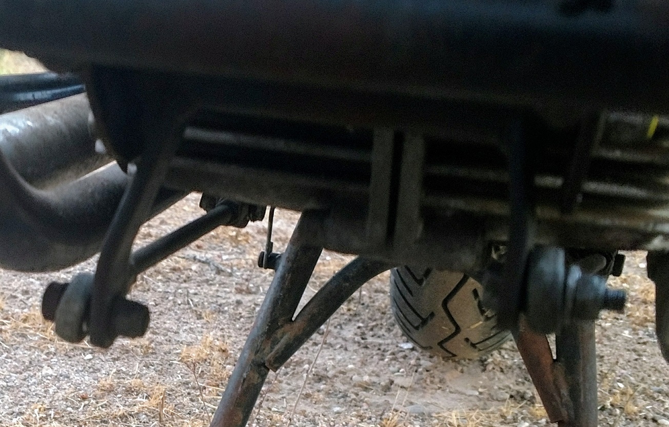

For those wondering...
Bell Crank on the front of the frame that transfers shift lever action from left to right. Picture of each side to follow. Hopefully.

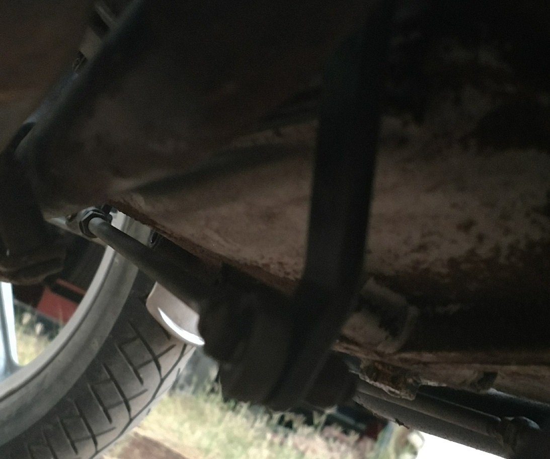

Shifter on the left, mounted probably where a brake lever would go, moves a lever on the backside that operates a bell crank at the front of the motor.
- shifter 2.jpg (248.53 KiB) Viewed 11115 times

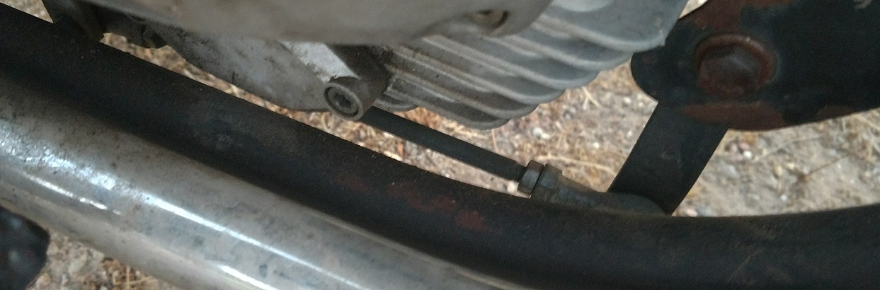

And on the right, another rod to the actuate the shifter...
- shifter 3.jpg (162.45 KiB) Viewed 11115 times

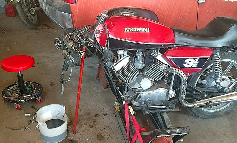

Tach is electronic and it has a bent needle from the heat. Not mission critical right now. I disassembled the speedo and lubed everything. Can seem to see any fault with it. Haven't tested it but spinning it by hand, the needle still jumps about wildly.
Last couple of days, I went to service the fork and found minimal oil, water in one leg. Pulled and cleaned damper rods. Replaced the fork seals and waiting on new dust boots. I also pulled the triple trees as I'm converting to a flat upper tree and going with drop bars. Took the time to paint the triple trees and going to clean parts as I reassemble the front end. New Avons arrived yesterday. Lost one steering head ball bearing so I'm going to a local motorcycle shop today to see if I can get a few when I buy some fork oil from them.
I guess I better check wheel bearings.
- No forks.jpeg (188.14 KiB) Viewed 10981 times
