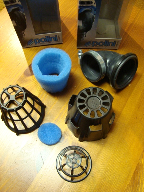

Hi, if your filters are the source of the problem? have a look at Polini 90 degree filters with covers as an alternative to the standard air box/filters and tuck up under the tank in still air, out of the weather etc and avoid some of the problems with K&N, Ramair etc filters especially in the wet.
The Polini 203.0098 air filter 46mm will fit Dellorto PHBH 26/28 mm carbs as fitted to 500/501 Morinis; I don't know about the 350 carbs but Polini make loads of different filters.
This is what they look like - https://www.puchshop.de/powerfilter-pol ... blauw.html
Scooter shops are the best source, they are available in the UK and should be around £18 each (or less).
Good luck, Ian

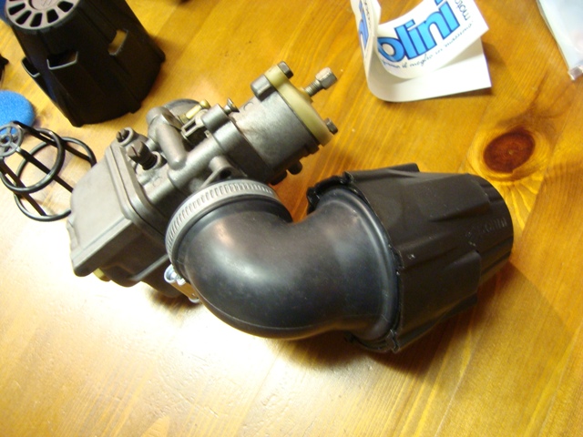

Hi, here are some more detailed Polini filter images (hopefully?) The carb is a 26 mm PHBH Dellorto from a 500 Morini.

'It must be a .....' wrote:Hi, here are some more detailed Polini filter images (hopefully?) The carb is a 26 mm PHBH Dellorto from a 500 Morini.
I'll second what Ian is saying here. It was he who put me onto these and I have a set on my Camel now, they work a treat. As he said they fit nicely under the tank and take up less space which leaves you more room for cable routing etc. The bike is running fine on standard jetting too.

Are you running them with or without the covers. Presumably you have oiled the foam?Steve Brown wrote:'It must be a .....' wrote:Hi, here are some more detailed Polini filter images (hopefully?) The carb is a 26 mm PHBH Dellorto from a 500 Morini.
I can definitely use them on the 2C/375 and a quick start up seems OK. A road test will be needed though.
Fitting them on the Forgotten Error with 125H tank will require at least a rethink on petrol line routing and possibly carb banjo orientation.

Re: Rough running
Yes, with the covers and oiled with some sticky air filter oil.

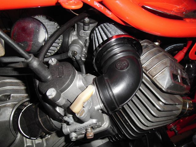

These Polinis are what I was looking for, but could not find them with 90° and 46mm. Thank you very much!
One of my spanish friends use them (but not 90°) in his race-bike and is content with them.
I don´t have much space under my tank and use some K+N replicas with the original snorkels of the 500 (shortend). After mounting a wind shield in front of the first filter the problem with rain disapeared, but I´m still not realy convinced with that filter, although I had no problems with them on my 5000km trip to spain this year

Great looking bike Norbert!
I have k&n r-1100 filters on my 501 dart, which have a 40 degree angle on them. That probably would not tuck in enough on a naked bike but works ok on the dart.
Having said that I’m tempted to try those polini 90 degree filters.
