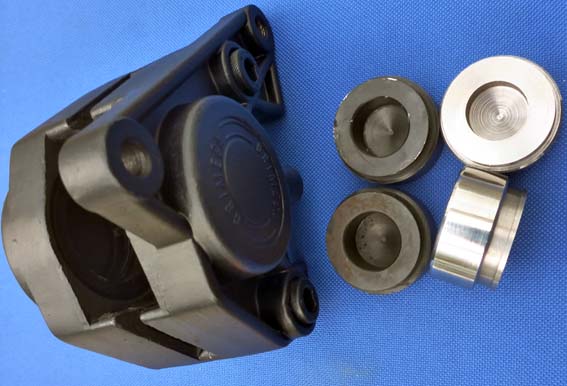

The stainless pistons appear to have been a success so far. I managed to get a nice smooth cut (it's 303 grade free-cutting s/steel) using a round-nosed profiling tool on a very slow feed. It was then just a question of giving them a quick lick on the buffing wheel and they came up like a chromed finish. They're a bit heavier than the original ali ones obviously though if the weight was ever an issue - which it isn't with my waistline
- then I could thin the walls down a fair bit. I left the dust seal retaining lip a little thicker than before just to give me a more substantial mounting to grip in the chuck for facing off the bottoms. Ignore the camera lens distortion - they are actually round

I've re-routed my brake lines now so that they pass between the fork legs below the bottom yoke and above the mudguard. It looks much better. I just need to sort out some guides to stop them rubbing on the paintwork. Something near to the front mudguard mounting bolt on the fork sliders looks favourite so far. I have some thin stainless rod that I'll have have a play with later this week.

nice job with the rake pistons, i did the same when my morini 350 needed a brake rebuild,
bought new o rings , and made stainless pistons.
has been in use for a season , should outlast the rest of the bike
