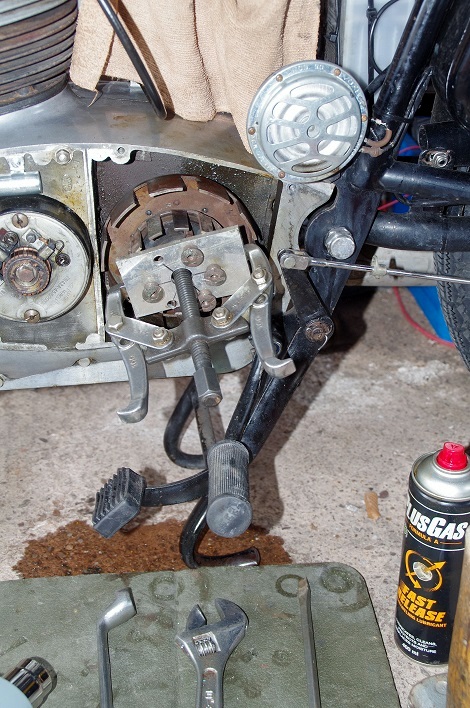

This is what I rigged up on the Gilera 175 clutch centre. The official puller replaces the pressure plate. I drilled a piece of engine plate thickness dural to fit the four remaining studs, with a hole for a two legged puller bolt to pass through. Tightened it mightily (until the ends of the plate were beginning to bend outwards) and then (after heat and shock 'n unlock) used a lump hammer *outwards' on the other ends of the puller legs. A picture is worth 1000 words. Nothing to attach the plate to on a Morini flywheel though, unless you made the plate of thick steel and welded it on.

Usually deployed to remove blind bearings from cases (or dents from bodywork). So not tapping inwars on the puller, but outwards. I simulated the action by whacking a lump hammer outwards on 'hooks' of my two legged puller in my photo.Lewes96 wrote:Not familiar with the ‘slide hammer’?
