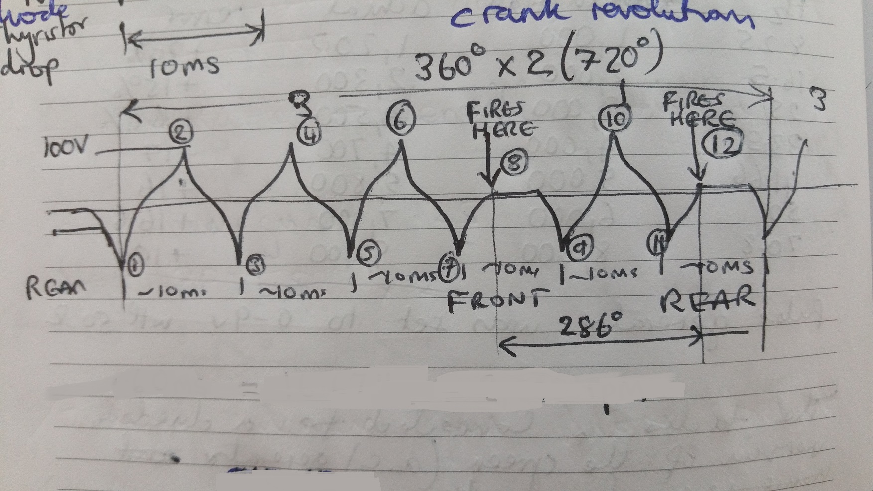

Please see my really scrappy drawing, this has annotations which are useful.
If you measure the waveform with the engine running you will see that it has 12 distinct phases in 720 degrees of crank revolution this is obvious because the generator rotor has 6 magnets If we take as our reference the passing of the magnet just after the rear cylinder has fired, we see an alternating waveform with positive peaks of around 100V at idle. This is not a conventional generator sinusoidal waveform because the circuit is driving a capacitive load. At cycle 8 we notice that the waveform is clamped to 1V, this is the front cylinder firing, the thyristor in the transducer triggers and shorts the green wire, thus discharging the capacitor of the front transducer and creating the spark through the CDI coil. The thyristor continues to clamp the generator until the generator voltage goes negative at phase 9. The rear cylinder fires at phase 12.
All the peaks should be the same, of particular interest is the peak just before cylinder 2 fires. A possible critisicm of the design is that the energy available to cylinder 2 is compromised and really a twin should have an CDI generator winding for each cylinder.
It is important that clamping only occurs in the phases shown, there is no wasted spark, that the clamp forward voltage is not more than about 1V. The negative peaks play no part in the ignition save to allow the thyristor to switch off. The transducers must never be operated from a d.c 12V source. Missing trigger will be evident. However the thyristor may trigger and discharge the capacitor but still there might be no spark. To see the spark needs the inductive pickup of the strobe gun (if you have it) exposed to the oscilloscope or some other inductive pickup. Now to increase the rpm and confirm that the waveform doesn't change in its form, the peaks should not collapse.
I can measure with some accuracy that the firing angle between cylinder 1 and 2 does not deviate from its ideal 286.7 degrees more than a few degrees.

The forum crops the picture, right click and 'view image', or even save it.
The alternator waveform isn't sinusoidal because it hasn't been deigned to produce a sinewave. The capacitor is only charged on the positive half cycle, so there can't be any capacitive loading on the negative cycle and yet the waveform is quite symetrical.
Paul is quite right, there is a diode in the transducer so only positive half cycles charge the capacitor.
The purpose of the crude drawing is really to show what the waveform should look like and what to look out for.
