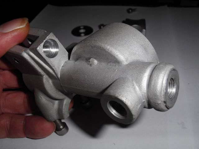

I presume the smaller volume inside the piston means it reacts more quickly to less 'squeeze' from the master cylinder.

Can't be that Ming,
The hollow section faces the pads, so fluid movement is identical. Possible that thicker walls distort the pads less? 'Feel' is always a difficult one to quantify from an 'engineering' standpoint.
