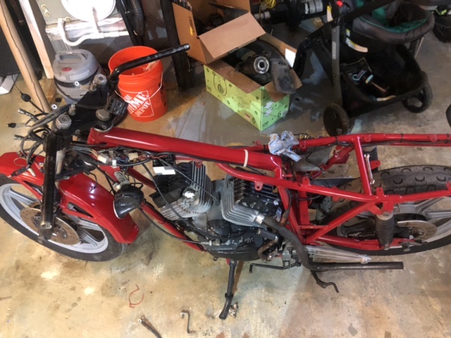

Made some more progress. I continued to strip down and clean the bike as my schedule with 2 small kids allows. Mostly soaking things in evapo-rust and the I’ll drop off parts at the platers/powder coaters.

Must have moved to Australia! :D

Ha! Just saw that. How do I fix that? It was right side up when I posted it.
