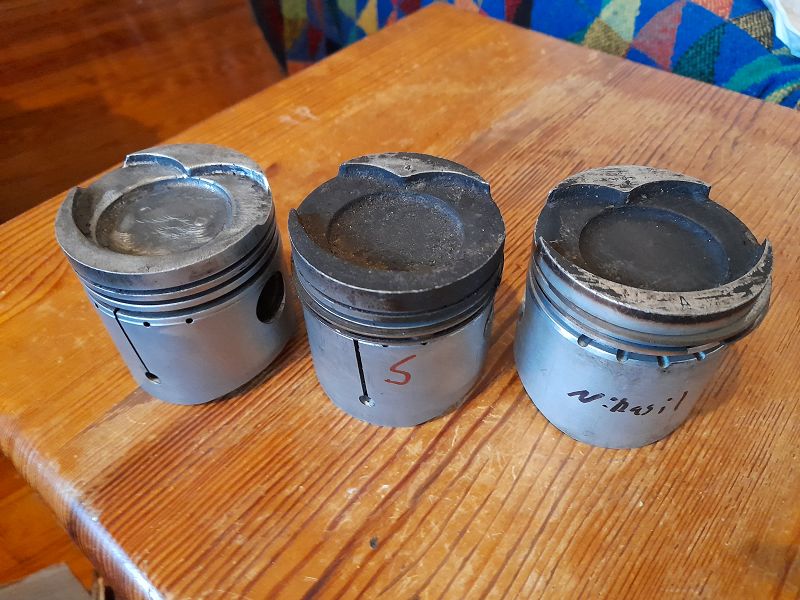

Often is an easier way to explain some things with fotos and hope that this is ok for you. It doesnt´t help to find the rings but may help to distinguish the pistons.
Here are three 350 pstons
from le left: Strada, Sport (o,4 oversize),Gilardoni/Nikasil
The upper surface of the Sport and Gilardoni cilinder (where the A of the Gilardoni one) are nearly 2 mm elevated compared toe the Strada, what makes the difference of compresion compared with the sport pistons . From the uppest point down to the lowest part in the center I measured a differnce of almost 2 mm (5 and 6,9 mm). (Take care when mounting a Sport piston in a Strada barrel. The rings will reach a bit higher so clean up carefully the coal at the top end of the barrel. this is nonsens, forget it!)
The Giladoni pistons do not have that expansion gap of the Sciam pistons. They are marked with the letter A or B and the barrels should wear the same letter. As far as I know that is the result of minimal differences caused by production. (a bit like the famous A, B and C cambelt pulleys are dued to tolerances in the production of the belts)
DSCI0092 [1600x1200].JPG (321.92 KiB) Viewed 4237 times

Thank you for your input Norbert. Mine are not Nikasil from your explanation and pictures.

I have to correct myself: The height of the rings distance to the gudgeon pin is the same with strada or sport pistons! I doubted about this and have had another look at it today. Sorry :oops:
But there is another thing to have in mind, concerning the oilring:
As far as I know only in the older motors there was a spring behind the oil ring only in the rear piston (please correct me to get out of doubts!). This ring is 4 mm high. I only have one of these pistons left, a Sport. All other pistons I have Sport or Strada have 3mm oil rings. I dont know if the first models also have a 4 mm ring without spring in the front cilinder, or if these pistons with 4 mm rings have been made exclusively for the old rear cilinder (I suppose for Strada and Sport the same). Obviously later Morini recognized that this was not necessary and mounted the same pistons front and rear without that spring and a 3mm oil ring.
I measured on the pistons I have the following heihgts of the rings beginning from the top in mm for 350 ccm:
Strada: 1,5 , 2 , 3 (without spring)
Sport: 1,5 ,2 , 3 (without spring) 4 (with spring)
Nikasil: 1,5 , 1,5 (with a step facing downwards), 3 (without spring)
I´m sorry for the mistake above. But hope that together we can find out how it really is, because these problems and differences show up from time to time and it´s always a puzzle to clear that things :wink:
