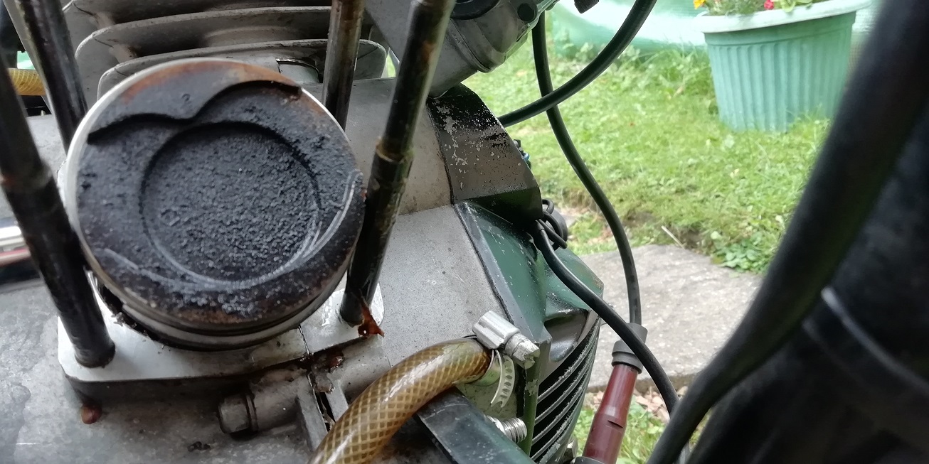

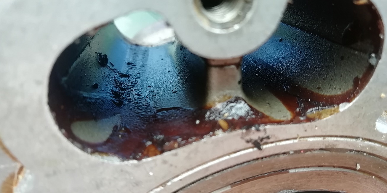

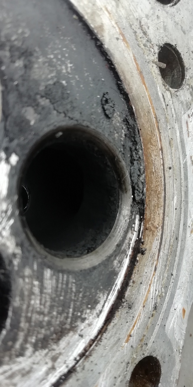

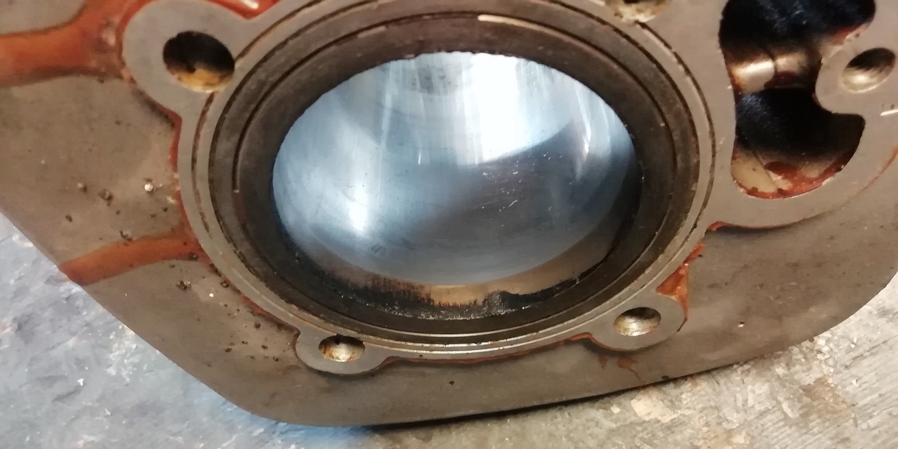

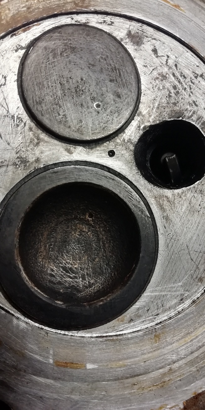

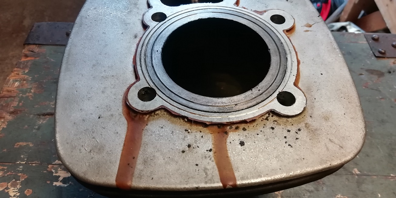

Hi, still working my way through the problems with this bike. I have noticed that there is no spring under the front cylinder oil ring as it says in the manual but have read in another post that this was only for the earlier bikes,(this is a Strada 81) also there is a dot on the cylinder head and dots on the valves and also a No2 on the piston and I can't see anything about them in the book, is the No 2 on the piston an oversize? I will try and add photos of the dots and No2 on the piston and some of the excess gasket compound someone has used.

The gasket was so well stuck to the head that I thought it was part of the head.
Posts: 1671
Re: gearing
Sorry I can't explain the dots or be sure about the number 2. I would personally disregard the dots as either damage from debris in the past or some previous owners marking to keep parts from a particular cylinder together. The spring under the oil ring is as you've read, only for older type pistons so wouldn't be expected on yours.
Measure the bore properly and you'll soon see if it has been rebored and determine the oversize.
What I can see though is a fair bit of carbon suggesting a reasonable mileage covered and potential wear associated. If the bores are not too worn a simple re-ring of the pistons, hone the bores and clean and lap the valves in etc should be enough. Obviously the bore wear needs to be assessed first.
Looking at the cylinder head the spark plug looks a long way up the hole. Is it partially unscrewed? Or is it the wrong type? In the NGK range you want a BP6 or 7 ES. The P and the E in the code are important to get the spark in the right area.

The 2 marking is for oversize, meaning 0.2mm or first oversize, measurements would confirm this.
I reckon the dots were made by a "mechanic" to keep parts together as Steve says.

Steve Brown wrote: 03 Oct 2023 11:10 Sorry I can't explain the dots or be sure about the number 2. I would personally disregard the dots as either damage from debris in the past or some previous owners marking to keep parts from a particular cylinder together. The spring under the oil ring is as you've read, only for older type pistons so wouldn't be expected on yours.
Thanks for your reply Steve, the dots are probably from some previous rebuild as you say so disregarded, good to know an oil ring spring is not required and isn't something that had been forgotten at a previous rebuild, the carbon you see is I suspect mostly burnt excess gasket compound, it was everywhere and I think it had got to the rings and seized them, I can't say it is correct but according to the clock it has done 41000k. The spark plugs are the correct plugs but not fully home. Thanks again for your help, Budge.

MickeyMoto wrote: 03 Oct 2023 13:33 Was it burning oil? How are the valve guides?
Hi Mickey, mostly excess gasket compound I think, I have never seen so much gasket compound used to put a cylinder head gasket on before. The valve guides are good.

mbmm350s wrote: 03 Oct 2023 14:14 The 2 marking is for oversize, meaning 0.2mm or first oversize, measurements would confirm this.
Hi Mark and thanks for your help, I thought the 2 was for oversized but thought it was for 2nd oversize, I agree with you on the dots.

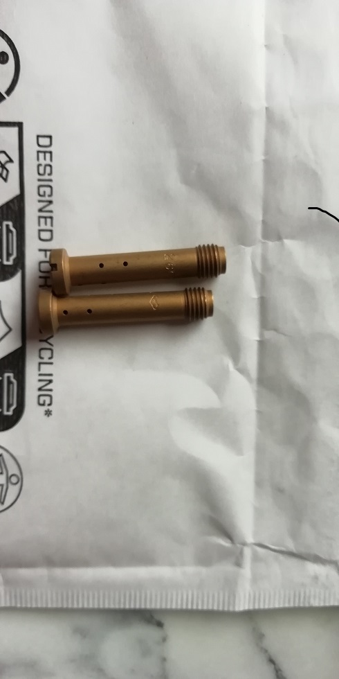

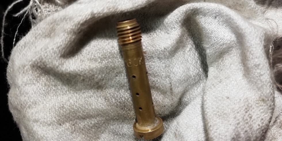

Update, but first I would like to thank everyone who commented and tried to help with suggestions. At last, I have found the problem and the bike is running 98% better (it just needs some fine-tuning now) after trying all the suggestions the only thing I hadn't tried was what Paul Compton suggested in one of his videos on Dell Orto carbs, he said that the 260K needle jet (atomizer) might need replacing with the 260 D OR 260 BD but the D and BD are hard to get, the K can have more holes drilled to make it into a D or BD, when I looked at Euro Carbs website to see where to drill the holes I found that someone had been there before me and the holes had been drilled, I ordered a new set of 260Ks (ordered from Euro Carbs on Sunday evening and here this lunchtime, Tuesday) and the bike is going so much better. Thanks again to everyone and Paul Compton for the videos, Budge.
