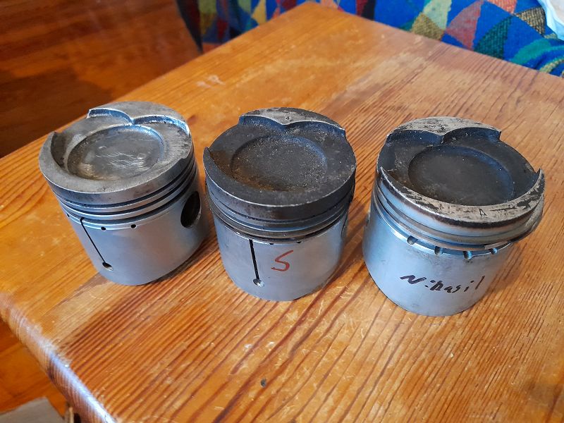

The Strada pistons have a distance of 6 mm from the lowest to the highest points of the upper "heron surface" . This distance is 7 mm with the Sport pistons, what makes more compresion. The pistons for the nicasil cilinders also have these 7 mm (perhaps a bit more?) like the sport ones.
from left to right; Strada, Sport Nicasil
With the nicasil ones there is less clearance between piston and cilinder (lees noisy) and the pistons don´t have the cut you see at the other two. And the bores for the oil have bigger diameter. The rings of the nicasil ones are less hard because the surface of the nicasil barrels is much harder than the cast ones.
Only the first rear sport pistons had a spring under the oil ring, because they thought that there would reach more oil than at the front one. Later front and rear pistons came the same without that spring because they found out that it was not necesary
