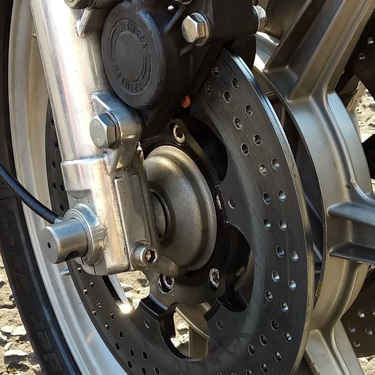

Discs by Roy Thursby
disc (2).jpg (397.72 KiB) Viewed 9078 times

Is there any problem going with a thinner disc? The semi-floating ones, I can source, seems to be only 4mm thick vs. the original 6mm.

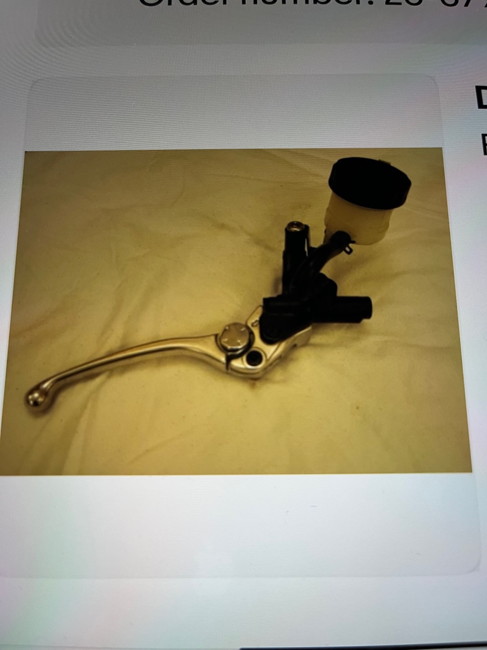

Paz2112 ref front brake master cylinder alternatives. I use a Triumph Sprint ST 955i front brake master cylinder ( other Hinckley models also fit ) which I got for 22 quid off eBay. Transforms the front brake action. Also use one on my Laverda triple.

Hello there was just reading through this thread and read your recommendation for a ST 955i cylinder - so all you have done is swopped out the stock master cyl for the ST 955i one, everything else is stock ?
Only asking because mine has double discs, and despite the brakes being very good, the action leaves a lot to be desired, if fitting a ST 955i cylinder improves things then it sounds like a worthwhile mod.
Rocker62
Posts: 147
Joined: 07 Aug 2024 22:01
Location: Shropshire UK
Re: Possible disc replacements
Post by Rocker62 »
Hi Andy it’s a straight swap. You may have to have the Triumph banjo bolt as off the top of my head I can’t remember if it’s the same thread size as the Morini. It makes a massive difference in feel. I have the banjo bolts if needed. They also have an adjustable dog lever for the span which helps too.
Steve.

I was lucky and got this for £22 a few years ago.

Thanks for that, might give one a shot on mine.
If it gives the brake a bit more "feel" / makes it more progressive that will do me. As it is the brake is a bit binary !!

Bought a 955i cylinder off E Bay for £27, now have it fitted, but not had a chance to ride it yet.
At £27 no great shakes if I dont like it.
Pushing the bike around the brake action feels a lot less grabby / binary than it did, the lever certainly feels less wooden.
Looking forward to some weather so I can take it for a spin.
