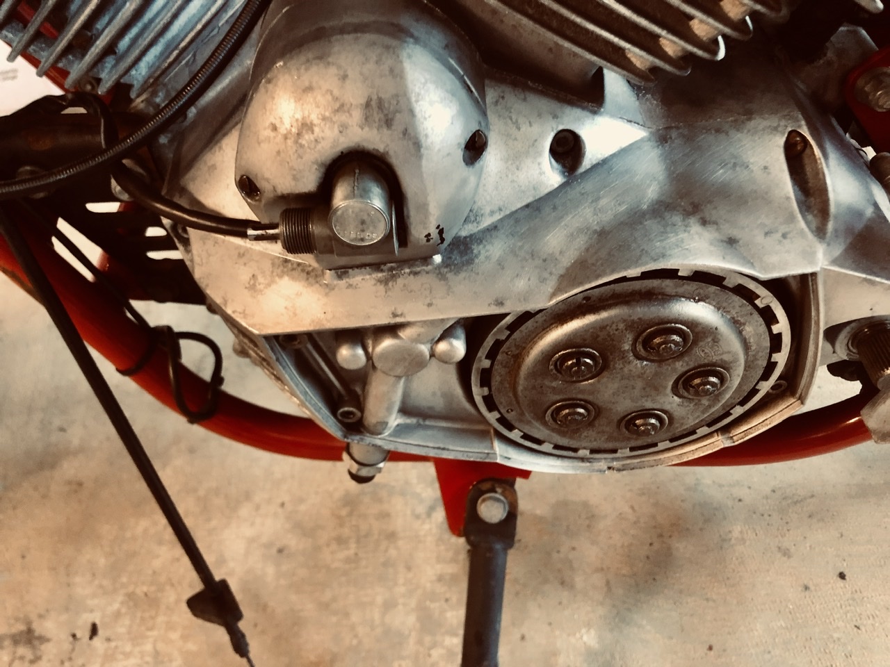

On the alloy, anyone have good technique/product for evening out the finish? See below:

I use my son, extra pocket money works wellR1100purist wrote: On the alloy, anyone have good technique/product for evening out the finish?

Haha that’s great. My son is 2.5 so his help generally results in disasters. I think I’ll use more elbow grease and “semichrome” metal polish from Deutschland.

The outer cases on my K2 are a black gloss paint/powder coat poorly applied over bare alloy, without primer etc. BMW use the same finishes these days! Don'ask!
At present they are not bad and the eruptions from corrosion beneath the coating are not severe. Unless you like polishing alloy, I would suggest taking the cases off and have them properly cleaned, primed and resprayed/re-coated, by somebody who knows what they are doing.

I had my K1 cases powder-coated in black. Looks the dogs!

I think rather than remove the clutch and do the “correct” thing with a satin black powder coat, I’ll just give the bare aluminum a good scrub and light polish until a later date when I “restore” the bike.

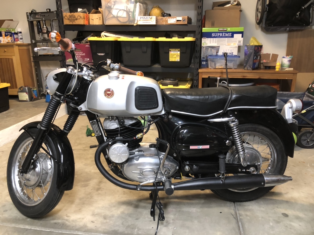

Didn’t get much done on the morini this weekend because I refinished my back deck and then went on a ride on my Puch 250 twingle but we’ll see what we can do this week.

You have a split single?

I do. It’s a 1967 Puch/Sears Allstate 250. It’s super elemental and has character in spades. Almost sounds like a 4 stroke due to the unique piston arrangement silences a lot of the 2 stroke “ring a ding ding.”

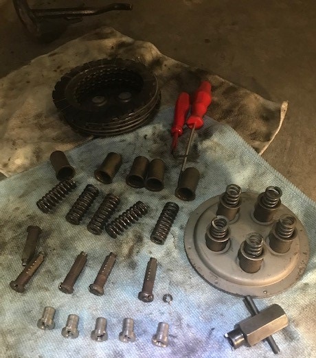

Hey guys! Useful post. So my 350 K1 clutch (not used since 1987) came apart easily enough... but the studs unscrewed out of the basket, and are still attached to the 5 screws. Are these just called "clutch studs" part 20.01.53H? Their male threads are soft... and not OK...
