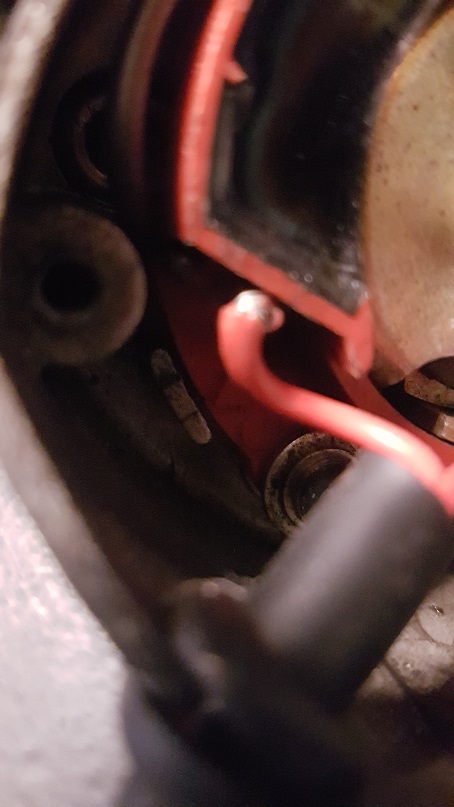

Hi All- I have made a short vid with sound to show what my ANT1 mark does at 6,000rpm (jitters a bit?) and to show the sound of the engine- slight popping/misfire? at constant 6,000rpm (second half of video). The idea of showing this is that you all laugh and tell me I obviously need a new pickup and rotor...The pickup is set with the arrow on the mark as usual and that seems to put the ANT1 mark as near to vertical as possible...

Have I seen this correctly? There appears to be no advance. The transition from tickover to 6,000 rpm appears to have little movement. It could be my eyes. How far around is the pickup? Does the arrow on the pickup point approximately to the timing line on the engine?

Matt,
Agree with Mike the advance is all wrong, non existent.
The engine runs clockwise when viewed from the Right hand side.
So when turning the flywheel clockwise ANT1 precedes PMS1 past the reference point , so as you rev the bike the strobe position of ANT1 should move to the left How about this for an understanding, if you had zero advance then the gun would show PMS1 as vertical wouldn't it.
As you rev it the timing advances and hence PMS will appear to move to the left, until eventually ANT1 comes into alignment
It looks like you are on full advance and revving doesnt do much except over advance it and cause misfire.
Timing should be at something like 22-27 degrees at fast tickover of advance. (27 is more likely with scooter transducers)
If you have the blue transducers you must rotate the pickup to retard by around 7-8 degrees of cam (14-16 degrees of crank) before attempting to strobe time. I think i already mentioned this. This is because the advance of the scooter transducer is designed for 18-23 degrees and not 34 degrees.
Hopefully below you can see the adjustment - this is a 250 which has same timing the upper mark is for standard transducers and the lower mark is for scooter style transducers. Your original reference point could be in a difference place, hopefully it was marked!

Thank you very much Mark, Mike + everyone else! Back now and reading very carefully. I’ll try not to ask anymore for a bit!! Thanks again!
PS addition: I retarded pickup as suggested and ANT1 starts to right of verticle/ clockwise and moves anti clockwise towards as I increase revs. …but it can’t get to vertical. Starts popping as when pickup set on original mark. If I retard more I can’t start it but will keep trying.

I have set the pickup as your 250 photo Mark and can get bike to start and it ticks over fine. On both cylinders ( I made an ANT 2 mark as advised) when I rev up to 6,000 rpm both ANT marks don’t move anti clockwise to vertical (advanced) position. The marks pretty much stay still and popping misfire occurs as in original position.

Hi Matt,
So it seems like you have limited change in advance on both cylinders.And importantly that the system can't sustain full advance
I am a bit confused as first you said there was advance and then you said there wasn't. The advance is pretty small from fast tickover to 6000 rpm it's only going to be 7 degrees or so or about 1/6 of the distance from PMS to ANT. Retarding an ignition won't make an engine harder to start.
I think you should try the spare pickup, set to the position I suggested for scooter transducers.
It's rare to have a pickup fault on both cylinders.
The too advanced and then timing goes backwards symptom is like what you see when a black pickup is used with early transducers. They don't have the diodes in the pickup. So is it possible that both diodes in the pickup have gone short circuit? There is of course a common earth inside the pickup.

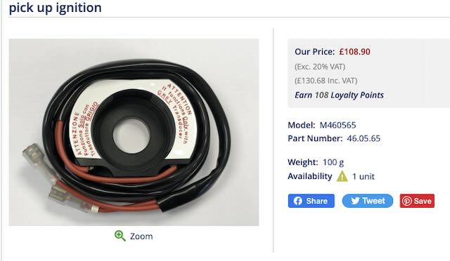

Hi All
I am hoping/ need to use blue ignition boxes-Ducati - (32398112) I am trying to order a replacement red pick up from Markus Heilig. <mheilig@freenet.de>
Does anyone know another option/place to get one?
I currently have a red pick up...so I am wondering if I can switch to use this black one at Modina? <https://www.mdinaitalia.co.uk/M460565.html>

Hi Matt,
Yes you can use the third series pickup (from the Kanguro/K2/Camel ) it is known as the black pickup the rotor of the second series as you have is compatible.
In order to use it with original black transducer or the scooter transducer you must put a diode in each red lead to the transducer. The cathode of the diode is connected to the transducer. The diode type is not so important a normal diode is good. 1N4007 or similar
You cannot use it without the diode modification and please don't try it, the ignition will appear ok for a while then retard.
You can also get a pickup from Mr Alex Luzzi of Siena (alex.luzzi@gmail.com in English its ok) it is also like the black but he will supply the diodes, but he can also supply transducers with exact compatibility with the black pickup, no need for diodes AND it has the tacho output.
I am running the pickup from Luzzi, 1000 miles no problems on a 350 its lovely.

Alex Luzzi can supply replacement exact replica for the 125H transducer (black green spot) .
To allay any confusion about the blue transducers on the twins these work perfectly, and are sold by the German suppliers.
but the tacho drive is lost.
I still think there is insufficient ability to compensate the system for the blue transducer on the 125H.
