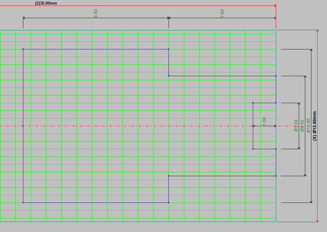

On my 250 I made a little adapter to take up the play. I have fitted it at the engine end.
Dimensioned drawing
Dimensioned drawing
Clutch Adapter.PNG (24.27 KiB) Viewed 8944 times

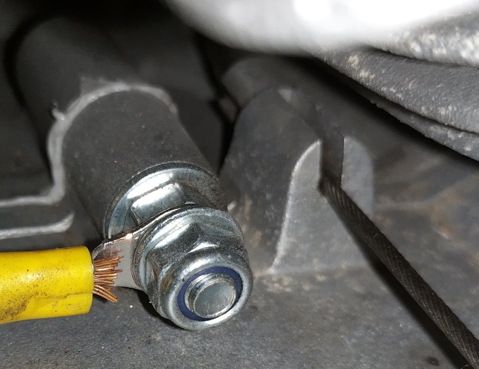

Hole drilled through the centre length.
A bit difficult to photo
20241027_clutch adapter.jpg (374.2 KiB) Viewed 8944 times
Not a very clear photo, sorry
A slot cut down its length to fit the inner cable through.
