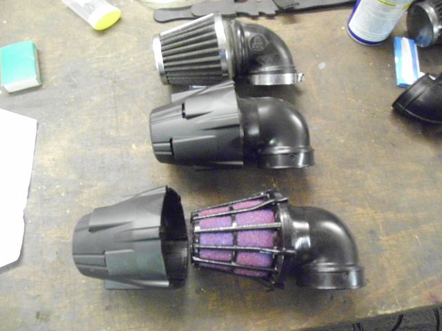

Hi, earlier in this thread I suggested using the Polini air filters as an alternative to the original filter box; I've used them on a 501 engine with 28mm carbs.
They are performance filters intended mainly for for 2 stroke scooters with the advantage of weather protection.
Steve is right and they flow more air without the cover as confirmed by a local scooter tuning shop (he uses very similar Malossi E5 foam filters but Malossi don't do a 90 degree filter).
Also with performance in mind you need to consider the filter oil you use, some filter specific oils are perhaps too thick and sticky for this type/size of filter; scooter tuning guy uses light engine oil.

Now that we have already invaded this thread about rough running talking that much about these Polini filters … here we go … for something completely diferent: The Larch (do you remember ?)
So I´m going to give the O-rings a try.
Dulcinea is quite slim and there is not much place for an airbox under my tank (an english one).

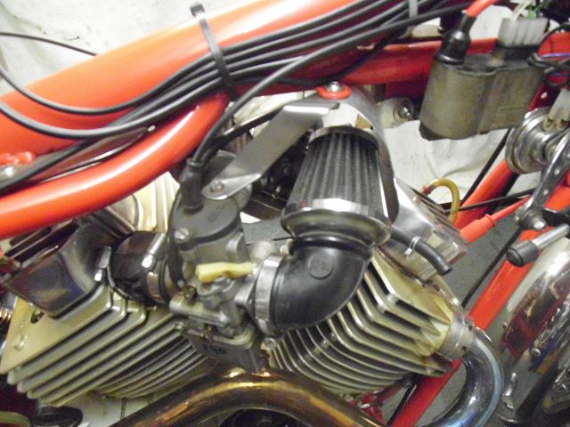

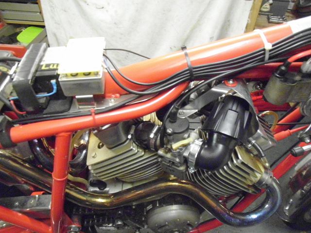

This ist the way I had it till now: the original 42mm tube to the airbox of a 500, cut between the folds, where I mounted some cheap K+N copies. After the very first real hard shower I fixed an alu plate in front of the first filter and from then on had no more extra problems with rain. But I´m sure that these filters are a mess, although I fear that there are more reasons than only that for the way the motor behaves. The carbs are supported from their caps to the original airbox boreholes. It seems to me that the rubber inlet manifolds of the 501 have the shortest lives of all. Don´t know why but they are a fountain of ongoing pain and sorrow. If you don´t use the original filter boxes, you have to catch the carbs anywhere! And this way you can take the filters of. They dont weight much the two versions, the Polinis even lighter and a bit wider..
After spending some K+N filteroil I wondered wether this was a good idea, treating a foam filter. We`ll see. I have to wait for dry streets, they are already salty.

I´ve done now 21.000 km with the pod filters K+N replica and Polinis together. The rubber manifolds are still in good condition (not sure that I ever reached 20k km with Rocinante with the original filter housings) and no false air intake ever :shock: So the hanging of the carbs are ok. I have taken off the carbs with the Polinis maybe two times and had to change some of the O-rings when mounting again because they are getting wider (now changed to 41/2)
