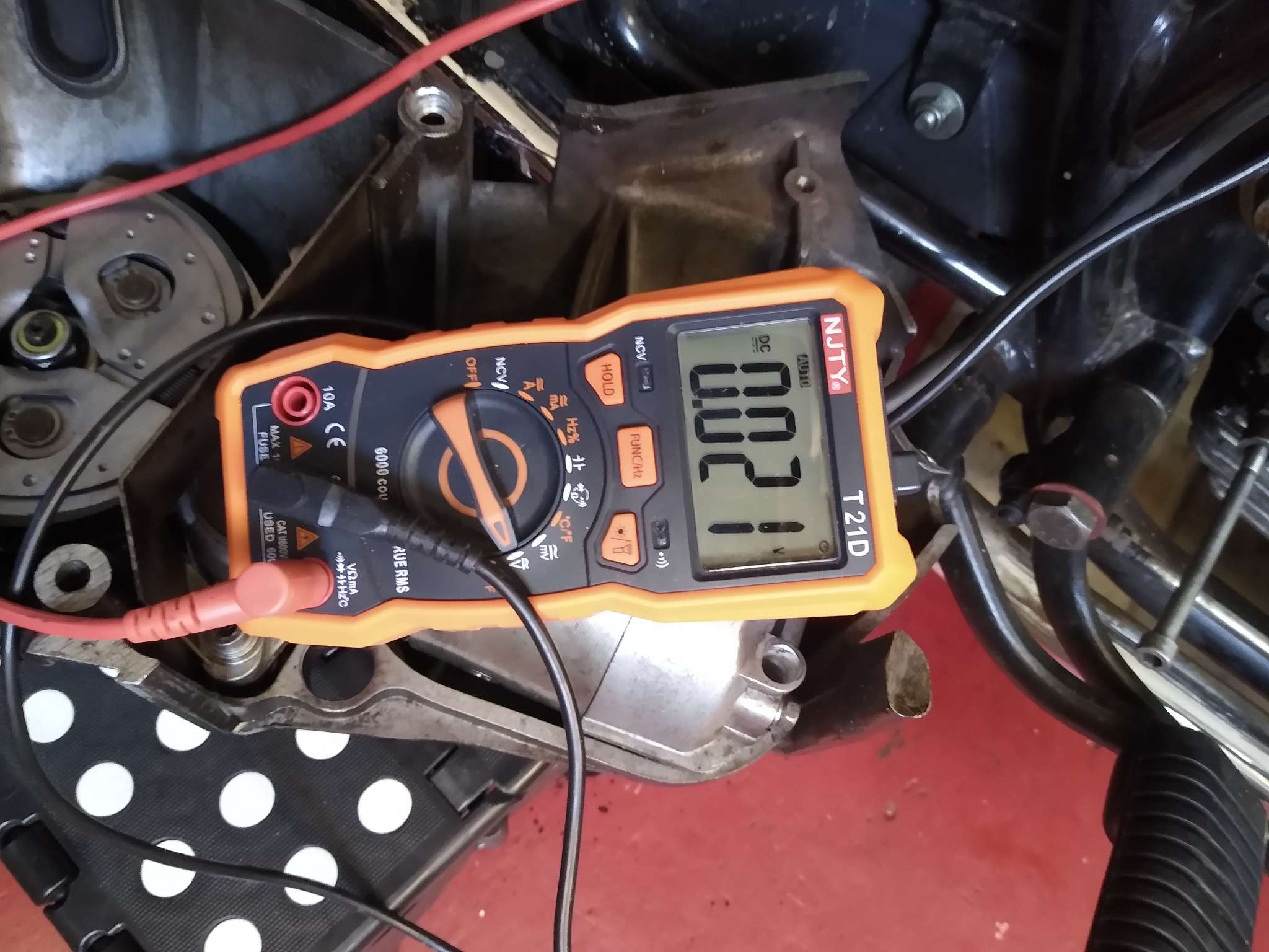

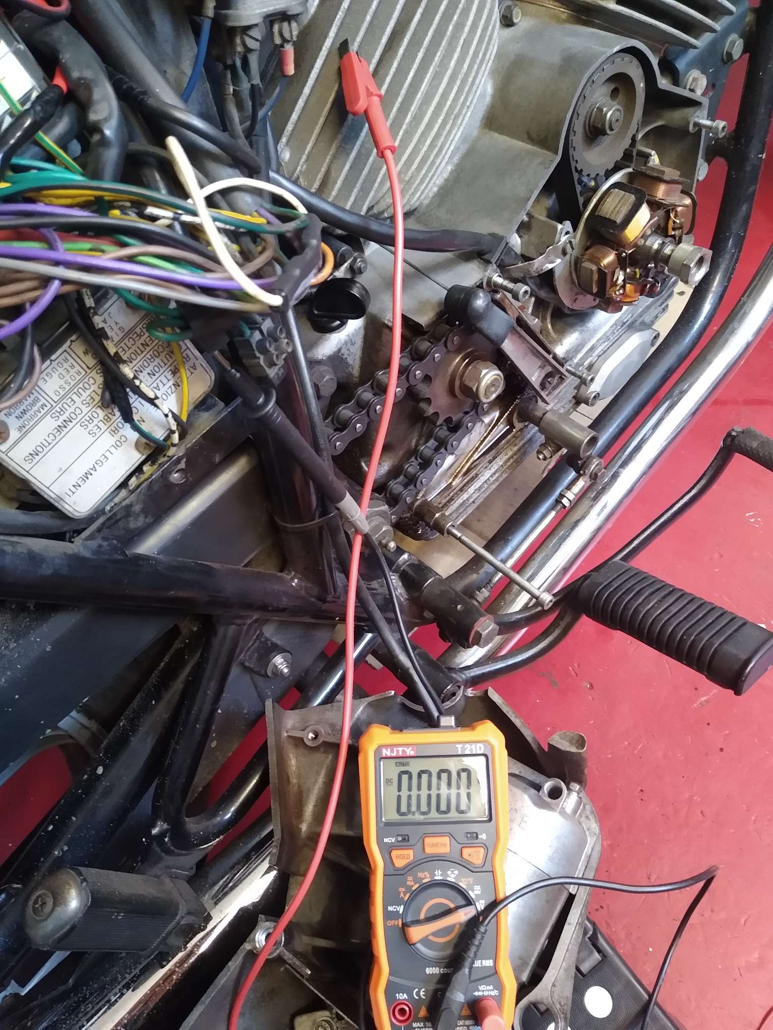

1. Meter set to DC voltage probe to green wire from stator and probe to cylinder head to earth. Ignition on
0.021 volts
2. Meter as above ignition off
0.000 volts

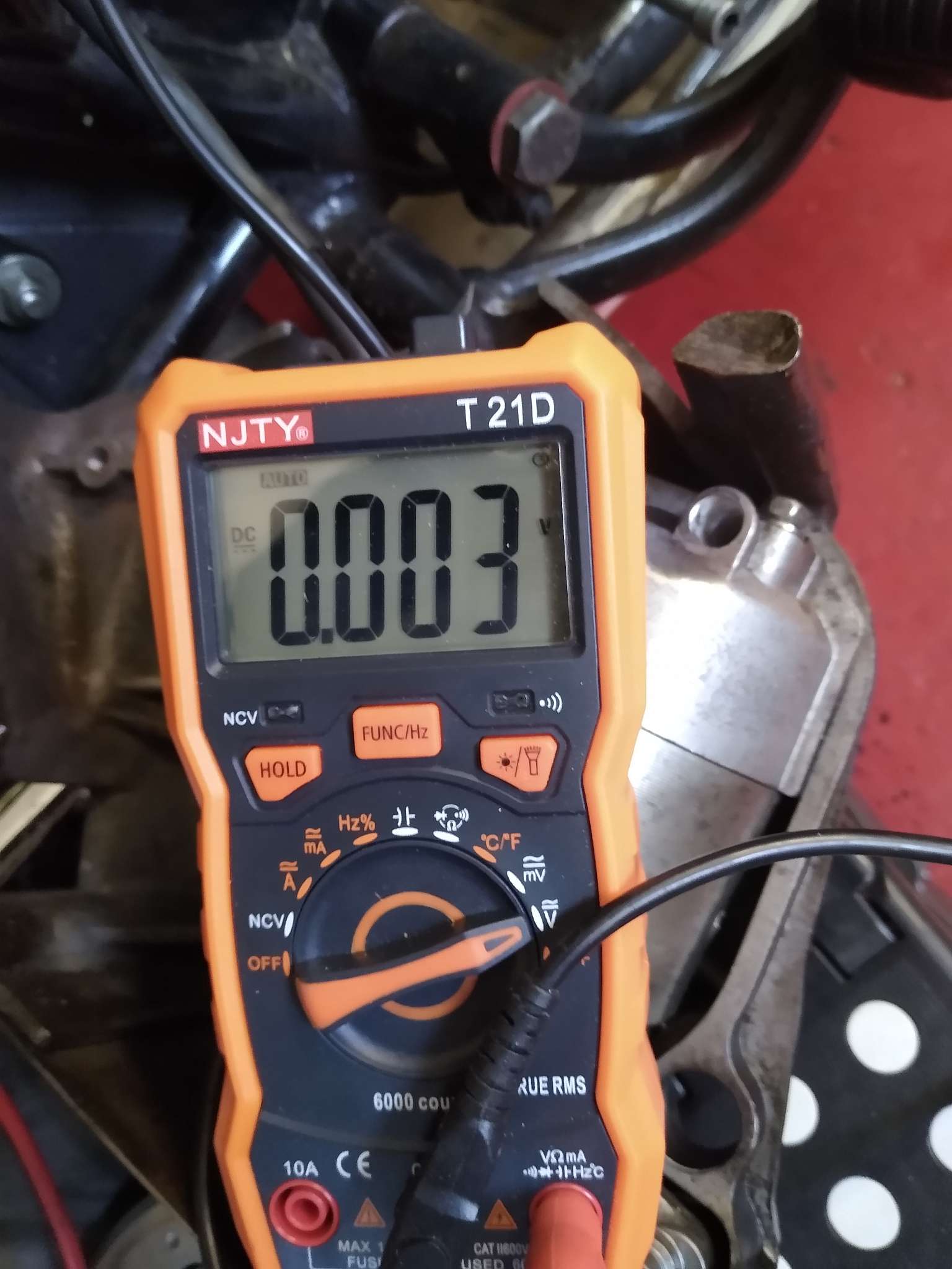

3. Meter connected to green wire and green connector in junction box ignition on
0.003 volts
1981 3 1/2 Strada

With the ignition on there is a DC voltage on the green lead, off there is nothing. Looks like you disconnected the green lead to measure. As far as I am aware, there should be no DC voltage present on this coil. Do you have a problem in the alternator? I believe when switched on 12 volts is put into the alternator, I think it is the red wire. If you disconnect this then measure again with ignition on what voltage do you get on the green lead?
Is the coil open circuit or short circuit now? ie what resistance do you have now?

MickeyMoto wrote: 23 Sep 2023 21:32 With the ignition on there is a DC voltage on the green lead, off there is nothing. Looks like you disconnected the green lead to measure. As far as I am aware, there should be no DC voltage present on this coil. Do you have a problem in the alternator? I believe when switched on 12 volts is put into the alternator, I think it is the red wire. If you disconnect this then measure again with ignition on what voltage do you get on the green lead?

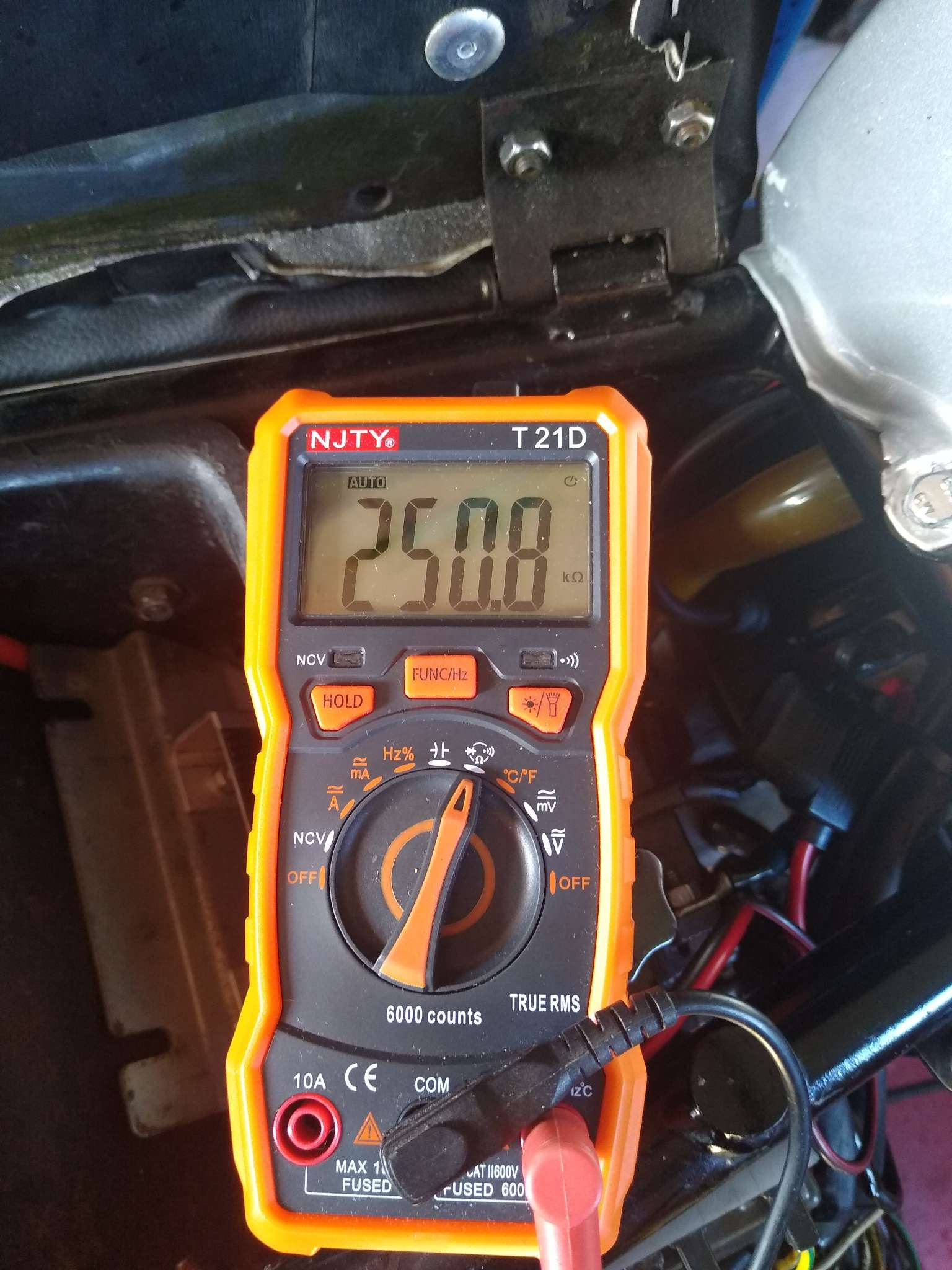

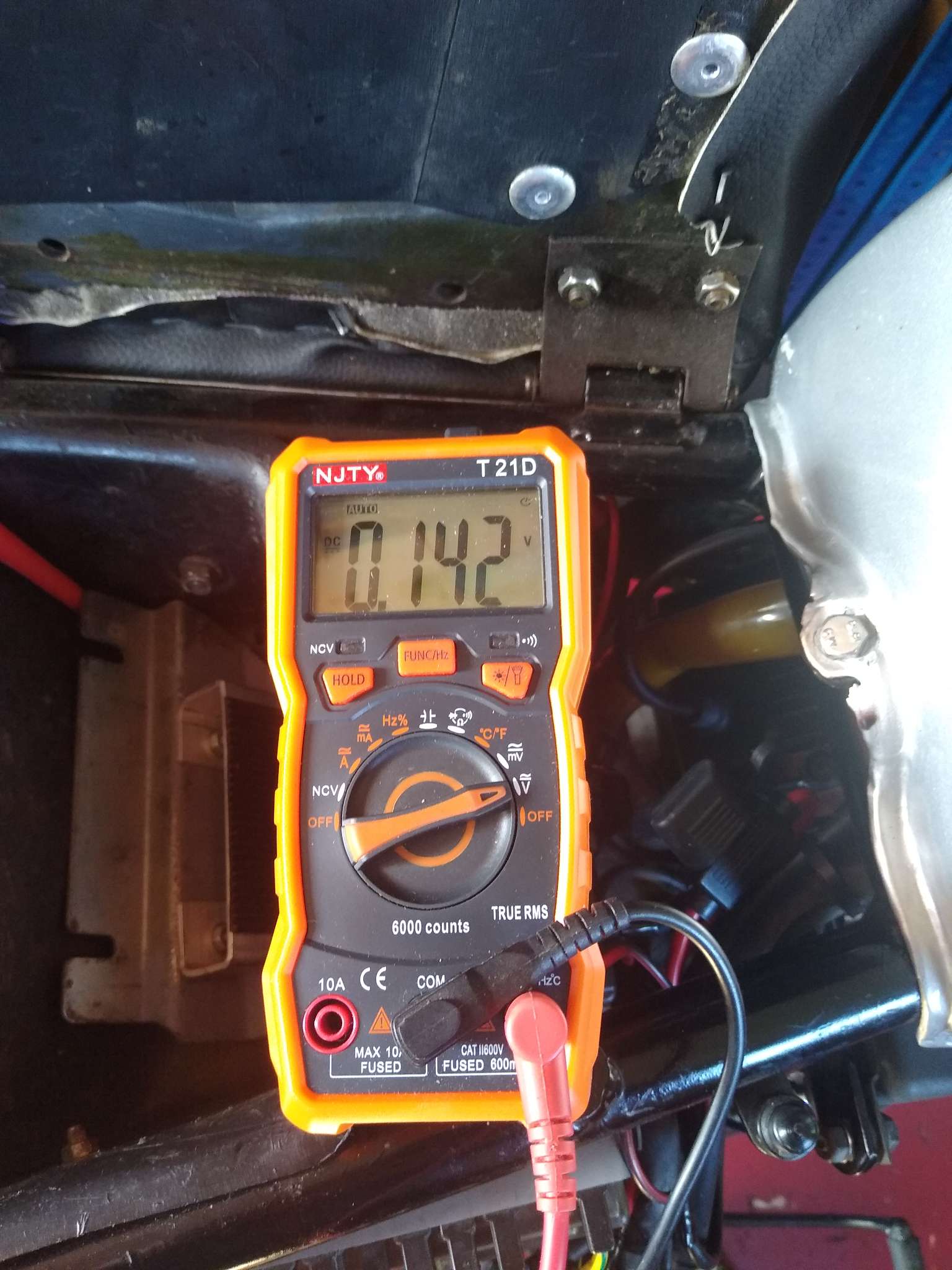

Voltage on green wire with red wire disconnected
Resistance on green wire with red wire disconnected
1981 3 1/2 Strada

mbmm350s wrote: 24 Sep 2023 07:24
With everything disconnected resistance measurements between green and all yellows and red these should all be open circuit. If available an insulation tester should be used to confirm.
Any competent winding company should confirm the insulation tests pass.

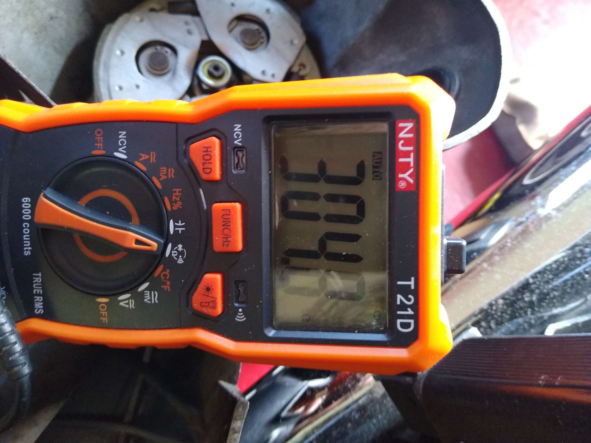

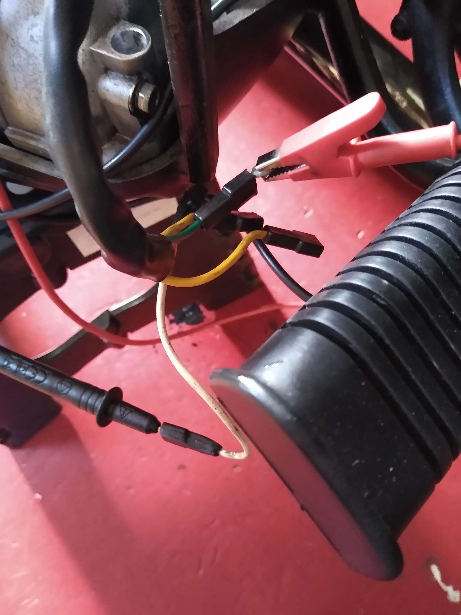

All wires disconnected and ignition on
Green wire to red wire= open
Green wire to 1st yellow wire = open
Green wire to 2 nd yellow wire= open
Green wire to white wire = 305 ohms
Same result with ignition off
1981 3 1/2 Strada

Fastmongrel wrote: 25 Sep 2023 10:09
Green to yellow as expected, open circuit. An insulation tester would be needed to confirm that there isn't an insulation fault (unlikely if the wires have been replaced)
The green to white/earth has reduced from 470 ohms to 305ohms, indicating that many turns are shorted due to insulation breakdown.
The loss of turns, and overheating will mean reduced voltage to the CDI and hence no or intermmitent spark
I haven't located a bare CDI bobbin of the correct large size, however there are the large lighting coils (PX series Vespas with electronic ignition) I think these are the same size available which can be unwound and the bobbin re-used
I would try Wasp performance, or SIP or Beedspeed.
