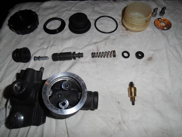

So lots of new parts have arrived from NLM and in it most importantly was the 16mm seal kit from Ariete. The kit has two seals and the rubber dust boot. My piston has three seals on it so my question is simple, which of the three seals does not get replaced?

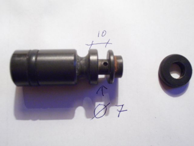

There is a problem about the 16mm Grimeca pistons:
There are two sorts of 16mm pistons! For the old ones (and that are normaly the ones in our bikes) there are no more seal kits available. As far as I know even in italy :roll:
This is the type of the old pistons
k-16er Handbremskolben altes Modell mit Loch in Nut.JPG (20.23 KiB) Viewed 23942 times

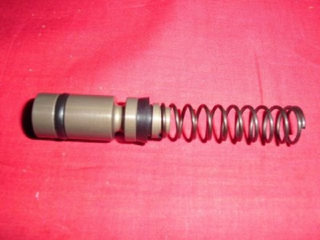

When I restored the last time a 16mm brake therefore I had to buy a new piston that has a complete diferent sealing ring (took me 32€ complete)
k-16er Kolben neues Model.JPG (33.81 KiB) Viewed 23942 times

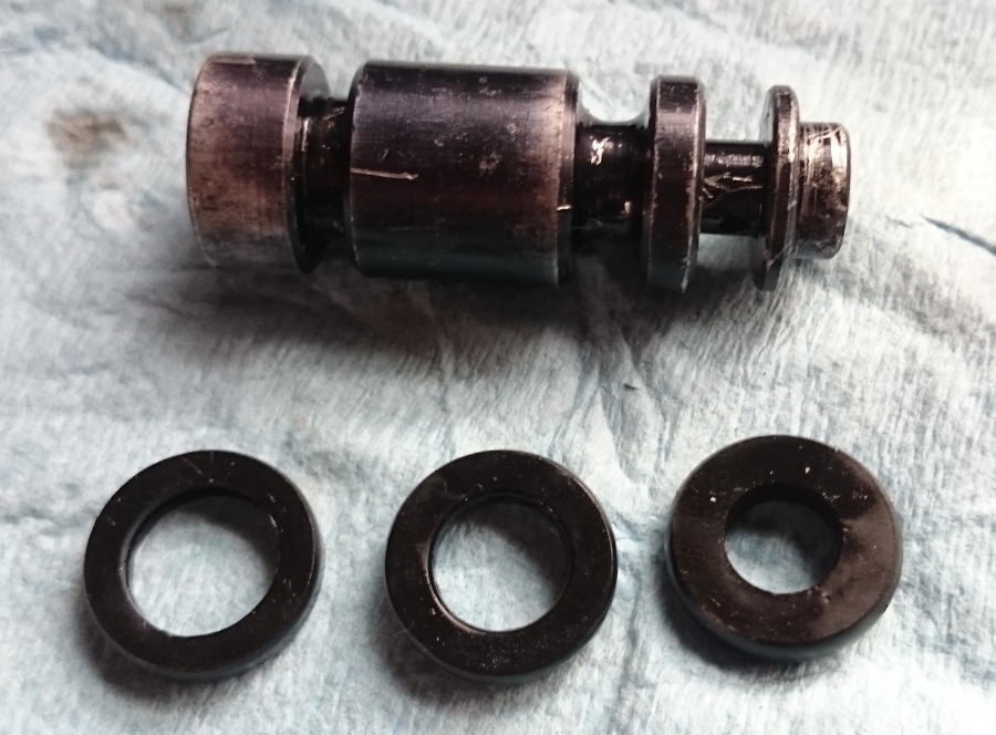

This is my removed piston and three seals (shown in the order fitted). The kit I got is from Ariete Cod number 12873-PO, it has two seals and a dust boot.
Norbert, The piston in your first picture and your second picture (red background) look very similar. What were the differences if any? DId you just use the two new seals and leave out the middle seal? From looking at how the piston works inside the cylinder I do not think that there should be any seal in the middle recess, I can't see that it would actually do anything. Maybe the kit is correct and some other bodger fitted a seal where it was not required.
Posts: 929
Re: 1977 3.5 Sport Restoration
Your piston to me looks like the first one (the old one). Normaly you won´t find this new generacion of pistons in a Morini pump.
Is there a hole in the first recess like in my first picture?
Then it should be the old one (don´t remember it well, but i think the new one does not have this hole).
The seal in the first recess (always counting from the outlet, the right site of the pictures) on the old piston is a massive ring.
This seal of the new pistons is quite diferent, its more like a collar not massive. The open part of that collar (don´t know how to explain it better :oops: ) shows towards the outlet.
Be aware that there are no notable scratches on the piston.
I agree that in the middel there should not be any seal!!!
So if your kit has that massive seal, it should work :wink:
