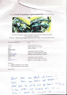

Has any one fitted NLMs new pick up and transducers with coils? I have just bought them but they neglected to give me the fitting instructions (wiring diagram) for the transducers and coils, does anybody happen to have some instructions?

Hi Simon,
yes, I recently fitted the transducers/coils and am pleased with them. Can't help with the pick-up though.
There is some logic to the wiring although the instructions I received were incorrectly printed. My corrections are noted. Also, depending on your bike's year you may have some wires left over that you don't need.
I ended up phoning NLM who put me through to the workshop and a minute's conversation later I was sorted.
If you can't read my greasy writing I can re-type my notes in another post for you.

- Transducer info.jpg (19.59 KiB) Viewed 11623 times

Hi Dom,
Thank you for the reply. Is it possible for you to e-mail me(simon@simonsworkshop.com) a copy of the fitting instructions, it is to small to read. The pick up fitting is easy.

Hi Dom,
What did it cost for the Transducer kit?
Any chance you could message me the page you attached as it is too small to copy or read.

Hi Brett,
the cost was somewhere around 130 quid but excluding VAT and including postage here to NZ. In any case, great value to make that part of the loom behave.
PM me your email address and I'll send you the PDF of the instructions.
