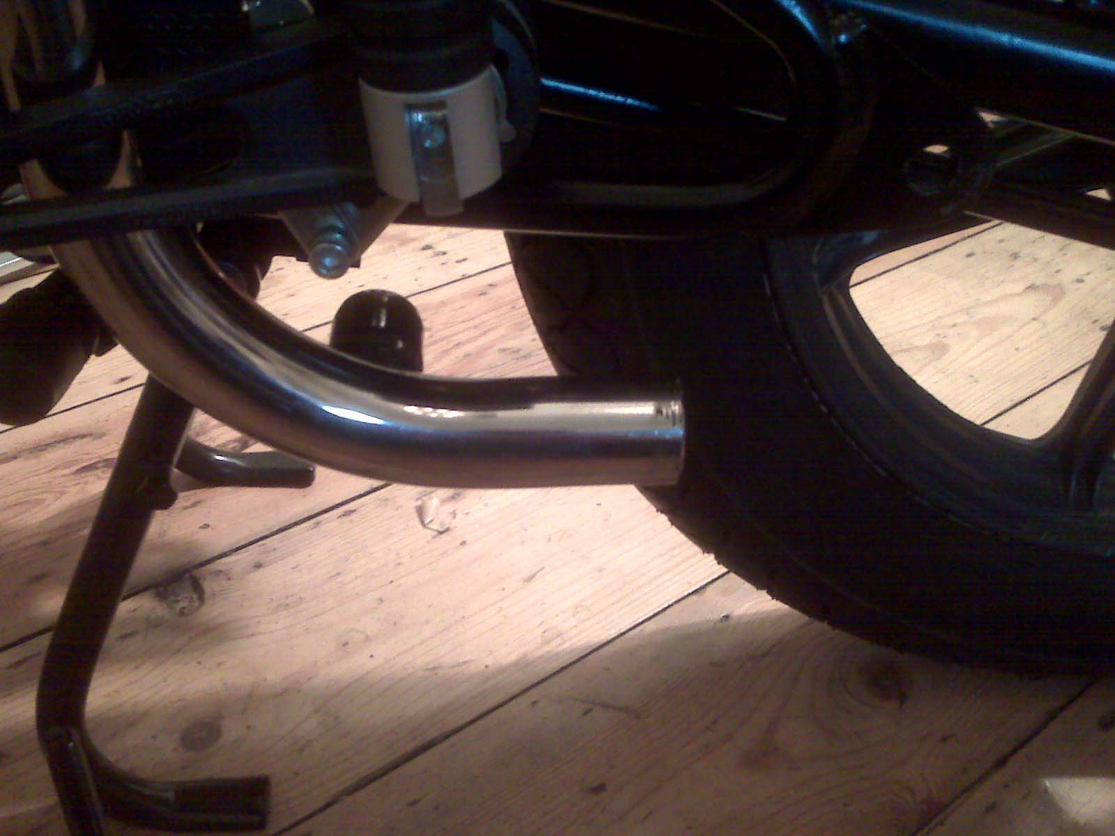

I've been restoring my "77 Strada and have at last come to fitting the exhaust - an exciting step forward, or so I thought!
I bought a new set of stainless steel downpipes from NLM about a year ago but have run into a problem. When fitted up they end up at outrageously different levels and slope angels at the back. ( Sorry couldn't upload the images for some reason)
After a lot of repositioning, playing about with the balance pipe, swapping silencers from side to side, measuring things, wondering about the silencer brackets etc it seems to me that either the o/s front cylinder downpipe upswept section ( at the back end ) is at too great an angle or the rear cylinder downpipe conversely hasn't got enough angle at its end so the n/s silencer runs out pretty much flat with hardly any upsweep! Or could it be a combination of the two? Has anyone else had trouble with these pipes and fitting or is there something I'm overlooking!?

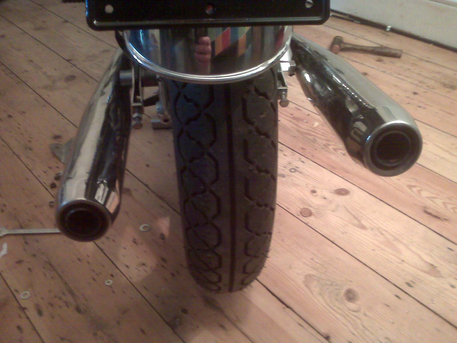

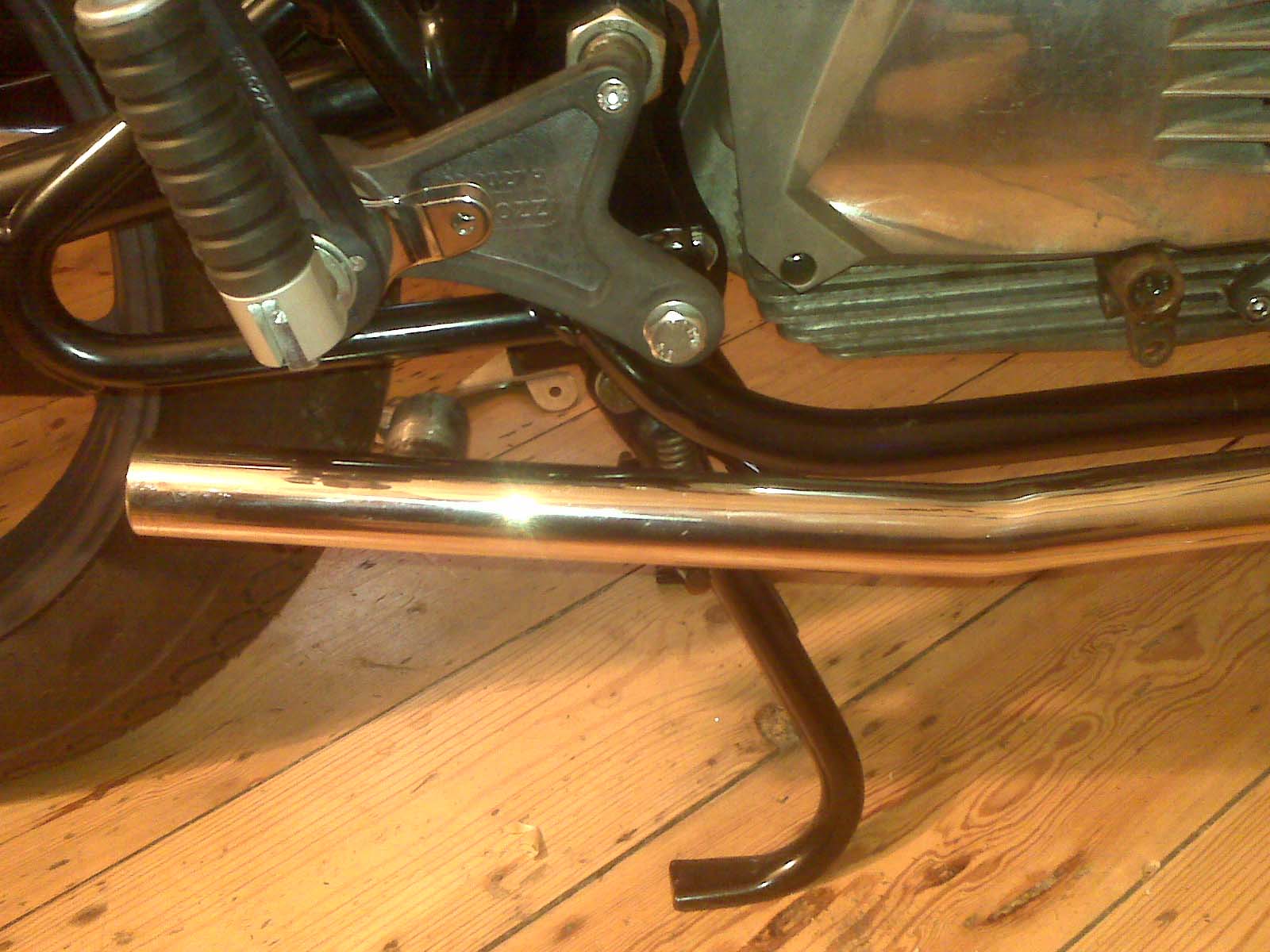

Thanks for your input chaps. I've hopefully managed to upload some images albeit of poor quality just to give an idea of how much these pipes are askew.
Not on the level!
Not on the level!
It has to be too much upswing - EV Guru good point about the possibility of these being for a 500. Presumably these had more of an angle on the silencer.
Swing high sweet chariot
Then the other side seems much better but perhaps almost too flat!
better but...hmmm
better but...hmmm
rear pipe.jpg (136.68 KiB) Viewed 8404 times
While I realise that restoring Italian bikes from the 70's you expect a fair amount of latitude in fitment - especially when dealing with after-market parts these are massively out - almost back to the levels of BSA and Triumph! I think with the Morini's delicate castle nut and port threads they should be a better fit and can't be wrenched around ( or booted into shape as I remember on my old Starfire!) I'm not keen on cutting and shutting the pipes - these are brand new after all. I'll go back to NLM - these aren't really fit for purpose.
