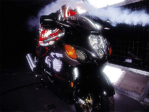

In a straight line though, the Hayabusa is king. It's drag coefficient is lower than on a Honda's 125 GP bike ... .561 vs .622 Amazing work by Suzuki.
Robert in California

Leaving aside the fact that it's very difficult to compare Cd figures because of the different methods of measuring frontal area, it's easier to achieve a low Cd on a big bike than a small one.smotorboy wrote:In a straight line though, the Hayabusa is king. It's drag coefficient is lower than on a Honda's 125 GP bike ... .561 vs .622 Amazing work by Suzuki.
Re: Factory 350 Road Racers
I think I understand you to mean that a small bike is of a certain scale, and as the human rider can't be scaled down to fit those proportions, then things are a bit more difficult to deal with in the packaging of the design.
A low Cd is a low Cd, and it takes a lot of effort to achieve one regardless of the vehicle size and type.
In my humble opinion, the Hayabusa has marked a new era in motorcycling, and that it is one of the most important motorcycles of the last 100 years. Before the Suzuki Hayabusa came along, more men had traveled to the Moon than had ever exceeded 200 mph on a motorcycle. Now, the short path to the 200 mph club at Bonneville, El Mirage, etc is to go get a Hayabusa and a "Power-Commander" and go for it.... Add a small shot of NOX or a turbo, and it is a sure thing...
PS: the total aero-drag of the Honda 125 GP bike is a little less than the the total aero-drag of the Hayabusa because of the smaller frontal area of the 125/rider (with it being such a small bike). GP engineers are looking for the lowest lap times rather than the lowest aero-drag. They have other considerations than all out top speed. Great engineering is the art of great compromises......
