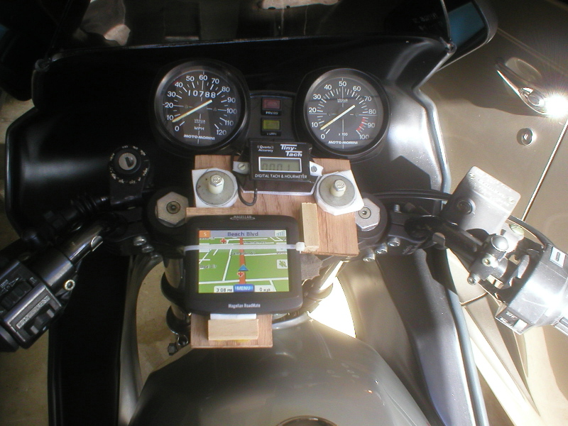

Flat road, no wind, and no traffic then high eighty's is normal....
Down hill or a good tailwind then the low to mid nineties is possible.....
As measured by GPS,,,,plus it takes a while to get the last few mph....
I did some testing before I started the modification to make it into a land speed racer...
Tach is very accurate,,, Speedometer was only 2 to 3 mph fast.... Not bad at all,,,I'm impressed by the allover quality of this little bike...
Robert in California

- P1010098a.jpg (236.98 KiB) Viewed 6888 times
