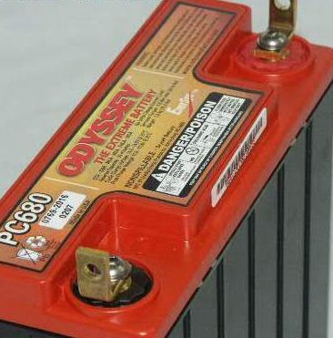

I have a PC680 odyssey which was OK widthwise but needed a rubber pad in front as its thinner than the standard one.Never any issue with it either. This on a 350K sport.

Having looked at the battery, after using WWW and 'PC680' as a search....
3potjohn wrote:I have a PC680 odyssey which was OK widthwise but needed a rubber pad in front as its thinner than the standard one.Never any issue with it either. This on a 350K sport.
...I see it has unusual terminals.
May I ask how you connected the battery up. Was it straight fwd?
Did you have to make/add some ' L ' posts (as above) or such like to fit? Any wiring changes?

Hi no L posts.I seem to have ring terminals on the wires which two allen headed bolts on the battery terminals retain. Bike came like it. Had to wedge a piece of rubber in front ( I glued it to the battery cage) as said as the battery is thinner. Cranks the starter motor/coffee grinder.Never ever needed a charge in 4 years.That's good enough for me.
