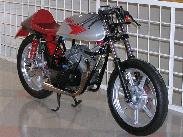

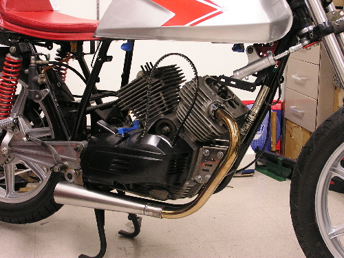

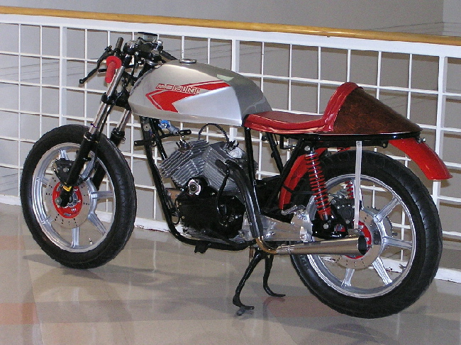

I have now finished making and mounting the full race megaphone exhaust system on the LSR K2 bike.... It will be interesting to see just where the torque peak is located in the rpm range with these units......Now, I must design and fabricated to a filtered air intake system....The air on the El Mirage lake bed is choked full of dust 90% percent of the time.....

Nice work, nice painting too

Thank You Mantaray for the nice comment......
The wheels , rotors, and rear fender are looking fairly nice.... I'm dragging my feet a bit about sawing and modifying that very nice Morini fuel tank, but it will have to be done to make more clearance for my knees and the carburetor setup....
The glossy black frame is in very good condition, however it will be glossy red when I'm finished with all the tabs and such yet to be done....I learned inspecting aircraft as a younger man that light colors show up stress buckling and cracks developing many times better than black ever does.....
Mainly Red with Silver as the other main color, White lettering with Black shadow accents, and maybe a simple Italian Green pinstripe separating the main colors are what I have in mind right now ......
We'll see how all this will look in a few months,,,,
