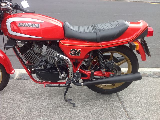

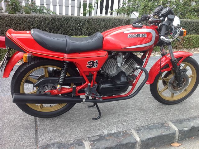

Here's the finished look a la rattle can.
