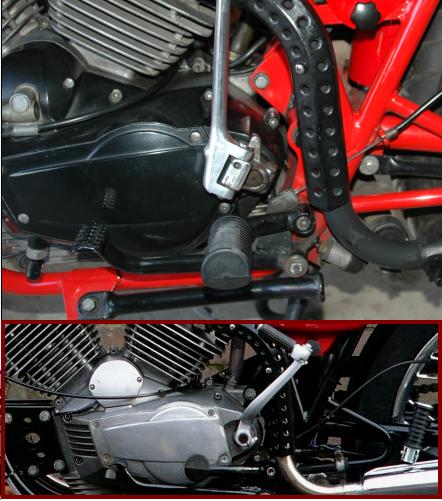

Hi Mark,
It will work providing that you don't have rearsets on it. Have a look at the Strada for sale at NLM. http://www.northleicestermotorcycles.com/sn2879l.jpg - See where the footrests are. If yours are further back than that, you run the risk of hitting your toes on the footrest when you are kicking it over.

...my bike doesnt have the Tarozzi type rearsets (but does have the semi-rearset ones that the factory put on the later models). My footpeg is about in line with the bottom / lower / right-hand clutch cover allen bolt. So I think the mounting for the footpeg is about 'half as long' as on the strada.
Sounds like it might be worth an experiment....I have tried to illustrate the sort of footrests on my 350K and one of the Strada's at NLM...

I have a Honda kickstart on mine, bent out with heat and that works just fine. I have Tarozzis, but I think if you can find a lever that works, go for it. Picture here. viewtopic.php?f=4&t=2553
