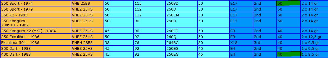

When cleaning the carbs i noticed that the slides are worn .
I used a set 400 dart-slides but now i see they are 40's ???
Optical they looked the same .

Re: carbs ignition or both ? (solved)
Post by mantaray »
changed the slide in the carb(s) and everything is ok :D :D :D :D :D
