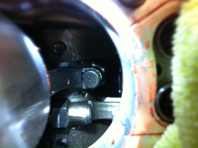

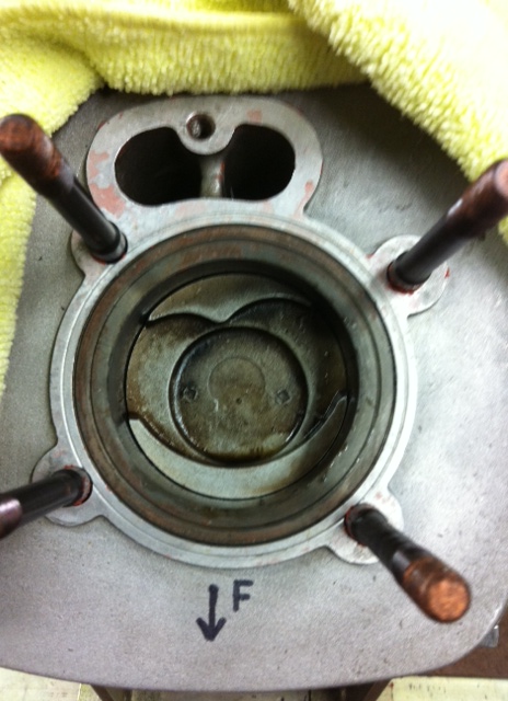

A recent private poster was worried that the pistons and con-rods of his machine were assembled incorrectly by some previous owner and wanted to see photos to make sure he assembled it correctly. Even though the manual has the drawings of the piston and the con-rod arrangement, since I was going to take the photos anyway, I thought I would post them here.
Front piston
Front piston
Morini 350 Front Cyl and Piston.JPG (117.82 KiB) Viewed 3536 times
Front piston skirt
Front piston skirt
Morini 350 Front Piston.JPG (95.33 KiB) Viewed 3536 times
Con-rod arrangement
Con-rod arrangement
Morini 350 Con rods.JPG (92.71 KiB) Viewed 3536 times
The wider side of the con-rod big ends face each other
