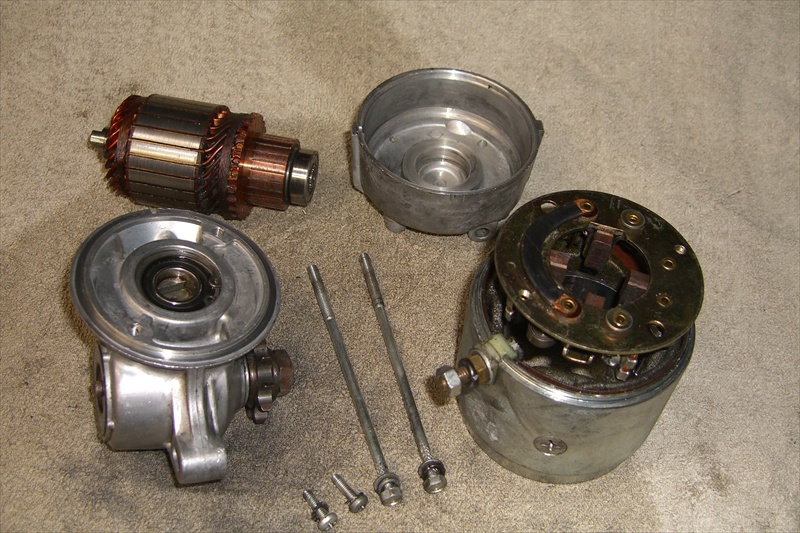

Post by HoveActually »
Here are photos of my starter motor dismantled, but after cleaning! It was really a mess because of oil leaks. The brushes must be in good condition (renewed if need be) and the commutator really clean, especially the slots between the copper lands.
With a 14Ah battery (pinched from a BMW K1300S - yes it does fit) the starter spins the motor easily; starting is immediate - pity it doesn't run thereafter as it should but that's the subject of another post.

Post by hotfoothowell »
Your suggestion seems to make sense, Paul. I guess the brushes could be worn/ stuck/dirty, so that when bench tested, the motor appears to be functioning, but when under load on the bike, they are not up to the job.
As for the gearbox, what I took to be a filler (not filter) hole - albeit somewhat small at 4mm -had nothing in its thread, and no oil emerging. According to NLM's book, it should have a filler and an oil level hole, so I am wondering whether modifications were made to let it run on grease. I haven't had the motor apart yet. Thanks for your contributions, Patrick
