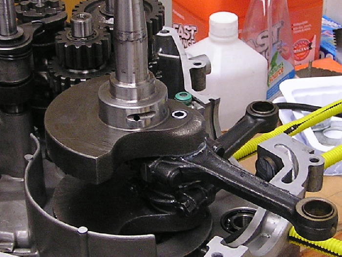

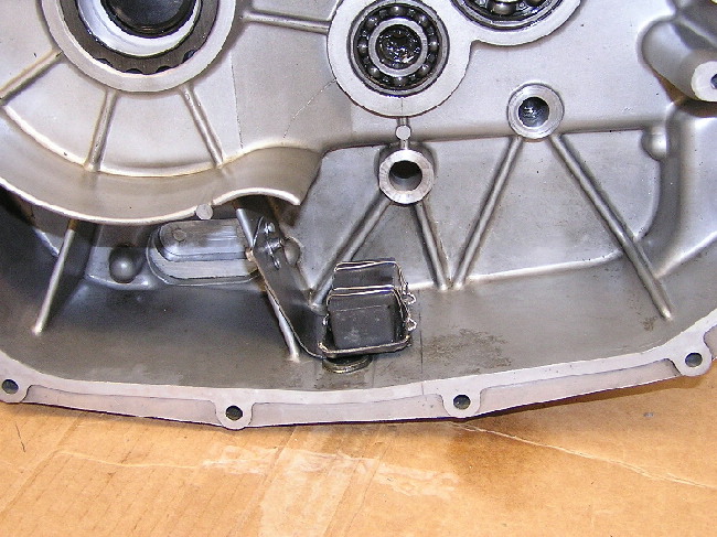

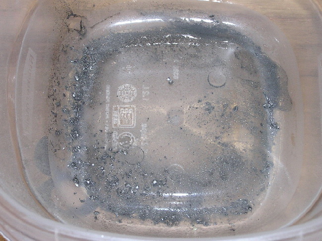

Re: SludgeTraps
Be Sure the Big one goes in far enough not to drag on the bearing !
I had to file mine down to get it flush ( before i installed for good) to clear....
What I flushed out of the crank explained the wear grooves in the bearings inserts,,,,super fine metal that the screen didn't stop,,,,The big chunks are from drilling out the allen screws
I've added a high-temp magnet to the sump to trap most of what the tranny generated....
Robert
