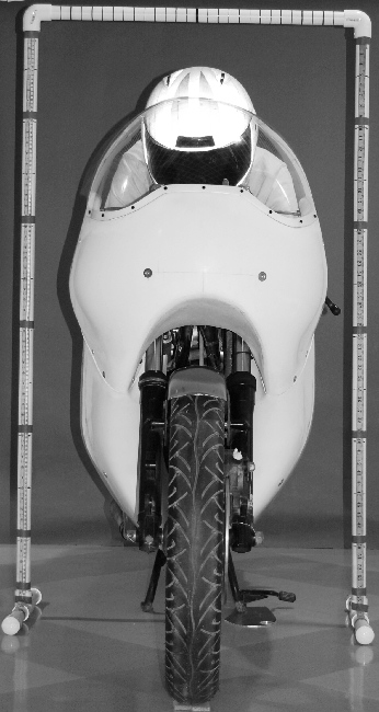

Hello All,
Here is a head-on picture of my Racer with the fairing inplace and set up to measure frontal area....
I now have the fairing pieces now painted and curing at home....
Motor is being removed for teardown next week..
Things are moving along....
Robert in California

For those interested, I have finished the initial frontal area measurements for the Morini.
Open bike w/rider with in a tight tuck has a frontal area of 6.2 sq ft and a Cof of drag of about .61
Faired bike w/rider has a frontal area of 6.4 sq-ft and a Cof of drag of about .42 ( based on numbers from the original race bike the fairing was designed for).
What does it all mean ? Well, on paper, the Moroni should top out around 200 kph (125mph).
Not bad for a stock motor with an add-on air pump and megaphones,,,,
If the numbers work out, of course...

Yup ! it was molded off original factory works parts from the early 70's.
As the original was a 750 bike. it needed cutting down to conform to the morini's slightly smaller profile, and it was a beast to get on it on the morini's centerline evenly .
I struggled for day after day with no luck till I remembered how the exhausts all ran on the same side of that road racer ....
As it turns out, the right side panel was made a little larger to clear the pipes.I trimmed down that side and everything started lining up.
I made several mods to further match it to the bike and me, and I have high hopes that it will perform very well at the track.
I can't wait to get all the painted panels back on the bike,,, It will be nice looking for sure....
