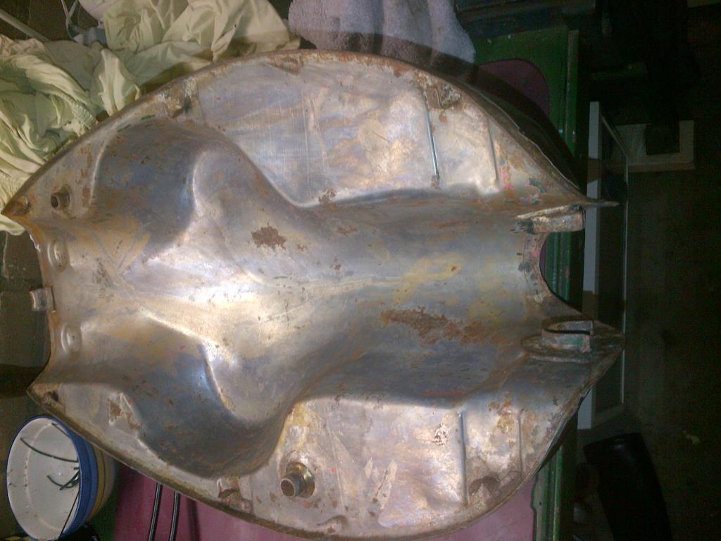

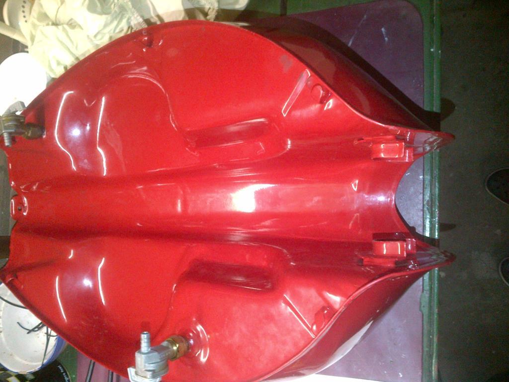

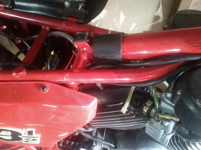

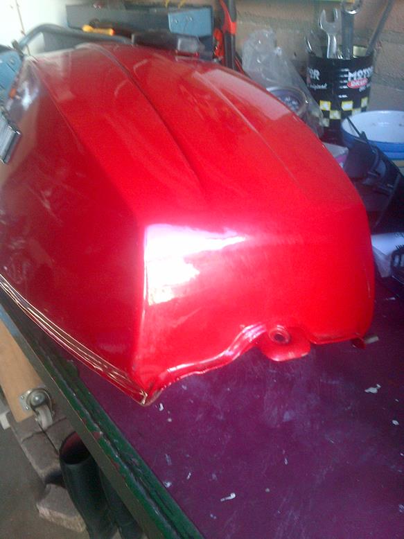

I'd like to see the other end of the K tank ,where it mounts to the frame-what kind of rubber bush arrangement should be in there? i have never seen another to know.
hendre
Posts: 600
Joined: 11 Aug 2007 06:51
Location: The Netherlands
Re: Petrol Tanks - interchangeable?
Post by hendre »
3potjohn wrote:I'd like to see the other end of the K tank ,where it mounts to the frame-what kind of rubber bush arrangement should be in there? i have never seen another to know.
here you go:
